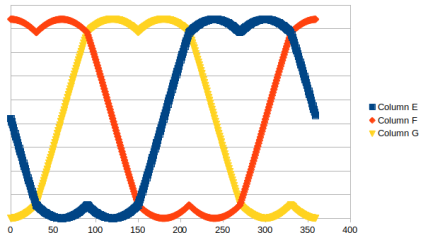

[ Upon seeing this thread thought will familiarize with overmodulation (in general, not VESC specific), so far i have been into basic FOC only ]
Following would be the per phase voltage waveforms without overmodulation,
And phase to phase,
With overmodulation factor of 1.15, per phase would become as follows,
while the phase to phase as below,
And with overmodulation factor 1.3, per phase & phase to phase would be as follows,
Per your graphs variation in duty cycle is less with increasing modulation. I am on a shaky ground here - wondering whether Leaf motor is a trapezoidal back emf type

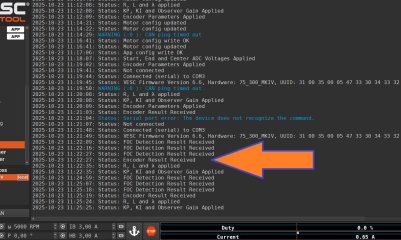

Ok, I effectively have problem with the MT6816 encoder.
It look like VESC detect something as it seem to detect encoder ratio (2147,5).
Two thing I'm not sure:
1-Encoder connections. MOSI = V+. See 3e pic. There is a MOSI on the MT6816. Is I have to connect it to V+ or no?
I've connect VCC to V+, CSN to CN... right?
2-How to set encoder on VESC? Simply select MT6816 in General Motor setting/sensor, select encoder in FOC Sensor mode and run Detect encoder... or there is a specific way?
I do not know how to connect that encoder to your VESC, but you can check the VESC for Bafang M600 motor controller schematic with that encoder and see how it is connected to MCU, maybe you need to connect it the same way.
It also looks like that encoder has multiple modes depending on how you connect it (you can check those modes in the encoder datasheet). But if you connected the encoder properly to set the encoder in the VESC Tool after connecting the controller go to "General"-->"Sensors" and in the "Sensor Port Mode" select your encoder, then click the "write the motor" button in the right side menu. Then go to "FOC"-->"General" and select the mode with encoder in the "Sensor Mode", then click the "write the motor" button in the right side menu. Then go to "FOC"-->"Encoder" and follow this sequence VESC for Bafang M560
After this the motor in encoder mode might start working. It also looks like the "Encoder Ratio" is equal to amount of pole pairs or half amount of the rotor magnets. So you also can try to count the amount of magnets on your rotor, divide it by half and put this number in the "Encoder Ratio". Do not forget to press "write the motor" button in the right side menu if you want your changes to be applied to the controller.
You're far better off getting an ABZ/ABi encoder. The mt6816 is good, I've used it a lot but the spi encoders aren't being actively developed and tested on VESC whereas the ABi ones are.
If you continue with the SPI one you'll need to select it on the encoder page before doing the setup. The ratio is the number of pole pairs so 2047.5 isn't a meaningful ratio.

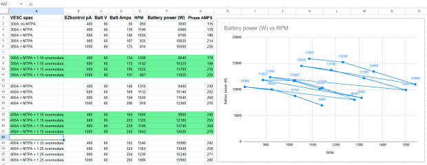

I was still doubt that overmodulation wasn't giving anything, so I tried some other tests.
Here is many nice numbers from my tests. Clearly, overmodulation give more rpm, but 1.25 vs 1.15 mainly give more motor loss (9% more power only give 3-4% more rpm).
Sadly, I stuck to have a nice graph with 5 lines for each different setting.
If someone can create a nice graph with those data, please feel free.
https://docs.google.com/spreadsheets/d/1l55PA_GWMiyrY8HDAXg9dPJcLT-LUvorUsZrS-LRVoY/edit?gid=0#gid=0
Based on data you can see above, passing from 300A setting to 400A setting increase power by around 15%.
This is despite the pA are only 226A to 276A max.
My question: how much power can I expect if I purchase a VESC Maxim able to 600A?
Another 15-20% or not?

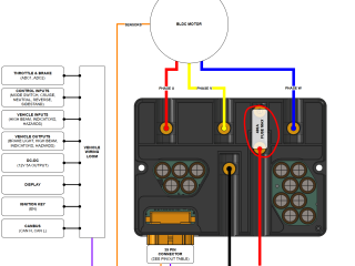

You can check the datasheets they posted. If you mean the VESC Maxim+ 120V 660A (I did not find 600A) it is capable no more than 350-370A (400A is the maximum fuse amperage they allow for this controller). 660A in the controller name is just to demonstrate the safety margin (basically marketing). The actual amperage is below 400A. And most likely below 350A (like 300-320A or so) because of this is the fuse they supply this controller with.
To calculate the maximum power just multiply the maximum amperage on the battery voltage.
Let's say you use 120V battery and maximum amperage is 300A. So you can expect 120V x 300A = 36000W of power maximum.
