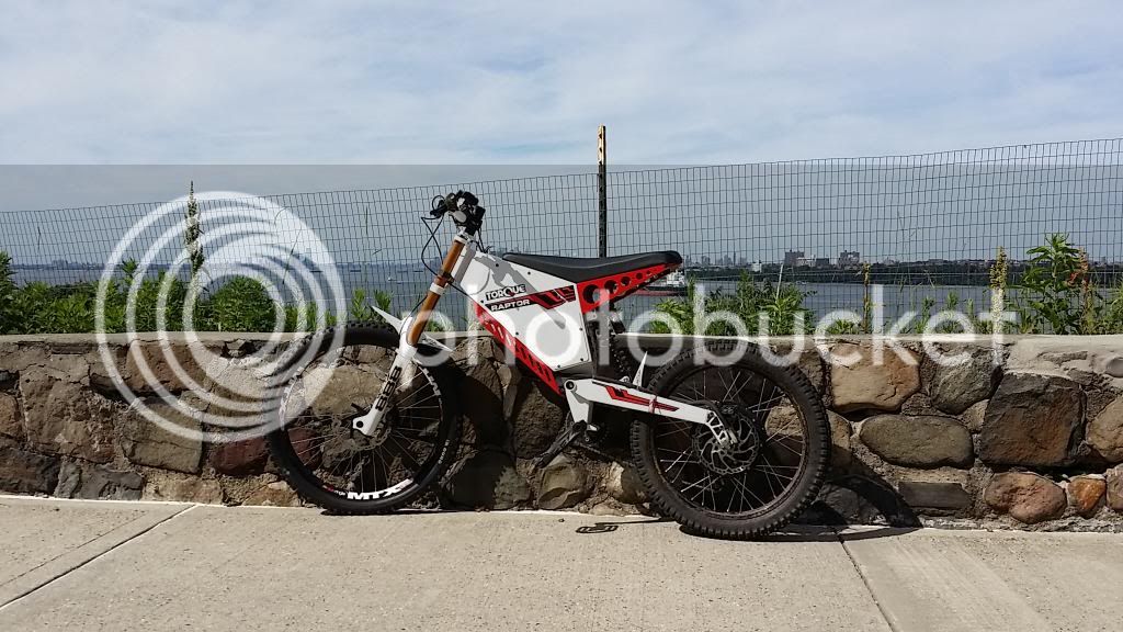

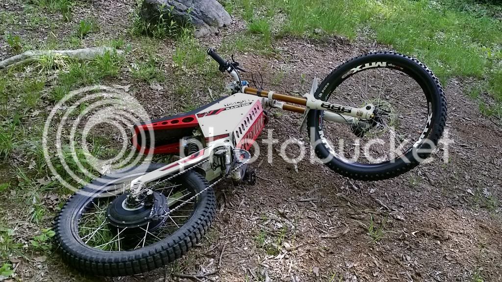

Just thought I'd give another review, I'm really loving this bike this summer, especially now having added the extra battery capacity. It allows me to go places I just would not go without it. Not because I couldn't reach the places, but once I got there I wouldn't be able to ride around the place for a long time.
The raptor never fails to also amaze me by how comfortable the bike is riding. The suspension is so soft, the motorcycle seat so comfortable, I can sit down through the harshest offroad trails and if I get thrown off the seat, I know I will land back on the soft seat someplace. I also have no trouble pedaling the bike as I do now more on offroad trails to help keep the motor cooler as I ride at slower speeds. Having that extra battery capacity also makes having that motorcycle seat so much more important as these rides last for a very long time.
Not only is the bike so comfortable to ride, it handles really well and has never lost traction once. The suspension makes the ride plush, but also doesn't bounce me off the seat either. I think I finally got it tuned properly now, especially the rear shock and spring weight. The Zee brakes just stop the bike instantly and are so smooth, you really have great control of how fast you want to stop.
The bike gets an extremely lot of attention from everybody, each ride I have very different kinds of people approaching or pulling up to me asking questions.
Some pictures below all on the same day and a single charge. Now I can travel far to different places and even ride around those places for a long time.
