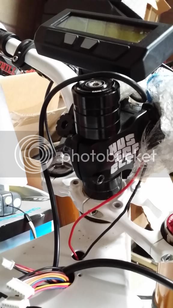

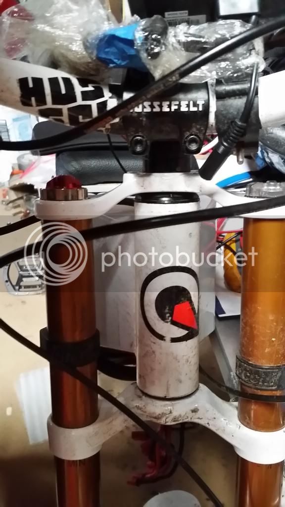

Dark Knight said:
Quick change of subject for all you Raptorites...would a 167mm steerer length be enough on dual crown forks for the raptor? The head tube length is listed at 150mm on Qulbix site so I'm thinking 167mm doesn't leave much room for spacers, stem and head set. I accept the head set doesn't take any length (I think....) and you don't necessarily need spacers...but 17mm still seems a little tight to me. Also removes the ability to play with stem (and therefore handlebar) height. Any feedback from those that are up and riding on the frame?
Reason for the query, I've found a pair of second hand forks but the steerer length is 167mm.
Nope, 167 is too short. I think the raptor has probably a longer head tube than any bicycle ever made.
I am not sure if torque raptor made the headtube a bit smaller with the newer frames, you will have to ask them.
My head tube measures about 150mm, then you need to add the headset, the smallest headset will add maybe 13 mm more, as that is what mine adds. Then you need to add in the top crown, which is about another 13 mm.
My stem is 40mm if you use one like mine. If you use a direct mount stem then you may not need to add this. However, the bars will be pretty low and on the raptor you really don't want to be leaning forward as that is uncomfortable and not really necessary on a motored bike in my opinion.
Will 167 work, nope, not on a dual crown fork. The head tube 150mm, + headset 13mm + top crown 13mm will be above this. So you will need minimum steerer tube of around 176mm if using a direct mount stem. Don't take these numbers 100% because I assume when using a direct mount stem you can place your stem cap directly on top of the upper crown.
Here are some pics of my spacing. I used a 40 mm stem and two 10 mm spacers. I actually never got around to cutting my steerer tube yet and it doesn't even look all that bad.
Thanks for the detailed feedback Offroader - that's what I expected. Ecruz also enlightened me a little earlier...
Suspect I'll be springer for a new fork sometime soon...need to make sure we got all the steerer length.
Oh well - budget was blown anyways...
As I tell others who either gasp at the price of a powerful ebike, it all quickly disappears when that first EV grin dominates your face :p
DK, the other thing to consider with that fork is if you're able to get it for a good price you can often get replacable steerer tubes. It might be a worthwhile purch if you're getting a good fork for cheap otherwise.
when you go with a CNC "Steam" thats in one piece, 167mm can be enough. When you want i can make a pic of a sideview. I think you need just 15mm for the Top Bridge.
Merlin, I don't think it will work at 167mm, measure your head tube, headset, and upper crown and let me know what you get. Because you're looking at 150 headtube, at least 10 mm for headset, and then you say 15mm for the upper crown. Maybe it can work because your steerer tube has to be a bit shorter for the top cap to fit.
What headset are you using? Do you have any noises from your headset? My cane creek is noisy and constantly makes a clicking noise.
