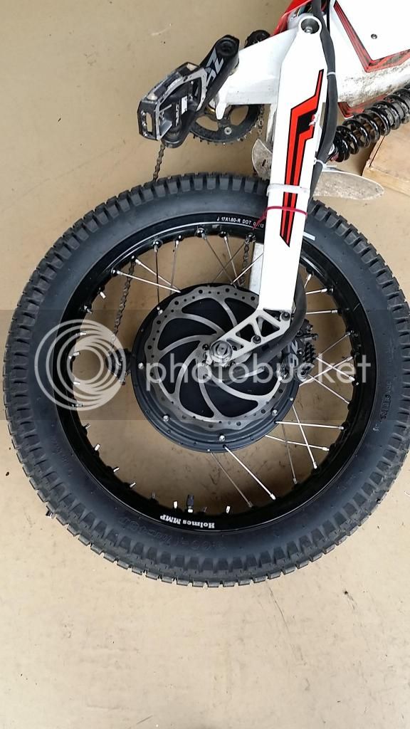

I just measured the width of the 17x3.00 tire on my Holmes Hobbies MMP 17x1.6" rim.
It measures ~3.26" wide. Did you expect it to be more narrow on a wider rim?

The 17x3.00 was much more stable in this dirt path that has a 3" rut in the dirt. I used to get kicked around a lot in that with my 19x2.75, but the 17x3.00 with the lower PSI and much thicker knobs was like riding in the rut wasn't even there.
I found myself wanting to ride over everything with that 17x3.00, it would cushion the rear hits a lot. I think key is to have a smaller rim and a larger tire.
The 18x3.00 tire is almost the same size as the 19x2.75 tire. It only makes sense that an 18x3.00 should be used in a place of a 19x2.75 for people who don't want to go as small as a 17x3.00.
I'm thinking if you're building an offroad bike then the 17x3.00 is probably the way to go.

The Shinko 3.5-17 is about 4 inches wide and heavy as hell. I was actully considering running it on my CRF250L becuase the 4-17 bogged it down in the sand. Its just to much tire for my 25 hp motorcycle. I really think the 3.5 wide Sr241 in any size would be too much for any ebike not running the enertrac 603 or Cromotor Mammoth. As far as 18" rims go, US Racing Boy rims has a black 18x1.4 which I got on ebay that I will lace up to my 5404 when it arrives. This rim is slightly lighter than the Prowheel racing 17x1.4. Borrani makes 18x1.20, 18x1.40 and 18x1.60 lightweight MC rims for anyone wanting to run this size like I am doing. http://www.borraniamericas.com/html/motorcycle.html Yah, at some point I plan on trying the 3.00-18 Sr241 on my Fighter. I cant do it with 4080, the chain line will hit the side of the tread. I had to cut the knobbies on the right side of the 2.75x18 SR241, just for it to barely clear. I could get a free wheel extender and it would clear. But witht he 5404, the stator covers are wider and it will clear anyway. Probably going to be a fall project.

Finally got my bike on the road today. It was a blast with the 17" tire, so much power and stability, it's like a different bike. I had it on gravel roads and I couldn't believe how stable it is compared to the crappy 19x2.75 tire. I took it down a road that was covered with fist size rocks that would scare me on the 19" but was very stable with the 17". I basically consider the 19x2.75 as a safety hazard as its such a crap tire compared to the 17x3.00.
I stopped to let my motor cool off and decided to quickly check spoke tension and true the wheel, it was perfectly true and is holding true since I built it. I was so happy about that.
I've been taking it easy with my rim as I have small 12 guage spokes and also do not want to damage my new cromotor.
I was riding in a park that had a very small hill and at the bottom of the hill is a deep valley, about a foot deep, that runs parallel with the paved foot path. I wasn't even going that fast and when I saw this valley after coming over the top of the hill I said "oh shit" as I knew it wasn't going to be good and I couldn't avoid it at this point. As I drove into it I heard a crack.
I think my rear tire caught the sharp edge of the paved foot path. Broke 14 spokes. At first I thought I cracked my new cromotor. I also noticed the lip on one side of my brand new rim was slightly bent.
I think if you hit these rear tires just right the spokes crack. They won't crack with jumps and normal stuff no matter how hard you beat it, but hit something at the right angle and the spokes just break.
This just sucks, I can't seem to win with this bike. I had to push the bike back home.
Looks like 14 spokes broke, I removed them as to not scratch the motor.
Rim got bent on the lip. I won't know how true it is until I get new spokes.

Maybe you ask HH about that disaster. as he is known to be "the best" wheel lacer, i would be interessted what he will say about that.
from my knowing it is not the 12ga. its the tension about the spokes.
spokes will break when they come losen. AND when all spokes are not on the same tension.
thats the secret about spokes. <- thats what a wheebuilder told me and for me it comes clear when i think about tension and forces on the spokes.
if they are to thick, they cant flex. all what they can do is brake.
when the spokes can flex and you hit hard rocks the wheel is maybe not true anymore. but the bike can run "home".

Once I was riding against the sun and I beat a rock very hard and my rim got bent on the lip also, no broken spokes.
What is your spokes length for the 17 rim?
Thanks E-fuel. The 17x3.00 is the way to go. I saw you post photos of off-roading and if you are doing that then the fatter smaller tire is well worth it. I hope you can get a shinko 17x3.00 in your country. You're going to have to keep the PSI low around 20PSI.
If you're using a cromotor and a prowheel 17" rim, or holmes hobbies 17x1.6 rim, I recommend 108mm spoke length. That should get you close to the top of the nipples.
This is what I hit below that caused me to break my spokes and bend my rim. It's about 10 inches deep.
