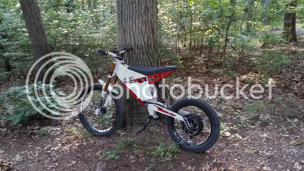

Man I had to repost a pic of Offroader's machine to get back on topic. Shit the bed ed! That lady is literally a quarter ton (500# 230Kg) of fun :shock: . Okay Offroader, been looking at your photo with the 3.00-17 SR241 and the 26 MTB up front. By eye ball, looks like your ride height is ideal, your fork tube angles look good, so even with the smaller wheel, your bike looks like it should handle well, like it did with the 19. Are your running a 10.5" (270mm) shock on the rear to keep your frame geometry in check? What did you come up with for shock placement on the frame and swingarm?
Rix, the geometry should have stayed the same between the 19" and the 17". I just lowered my 10.5" shock down one notch as seen in the picture below. My swingarm is an older version and doesn't have adjustments there only in the upper shock bracket. I measured the bottom bracket afterwards and it was around 14". I measured the bottom bracket height when I first built the bike with the 19" tire and it was also around 14".
Rix, I think the bike is perfect now. I don't think I can honestly do anything to make it handle better. But who knows, I never figured the 17" would be that much better. I would have never tried the 17" tire if holmes hobbies wasn't delayed getting the 19" rims. A 17" is a no brainer really on the raptor because of the adjustable suspension.
I do wonder if I would like the narrow frame of the raptor 140 better. I don't pedal anymore at all since getting the 17", the extra climbing ability makes pedaling even more useless.
I'm running around 15-17PSI in the rear tire. I think this low PSI makes the biggest difference in handling, especially because it cushions that heavy hub motored rear. I am also happy to know that the big fat low PSI tire probably also takes a lot of stress off the cromotor during hits. I don't think 15-17PSI is low because dirtbikes use around 10PSI. I can probably even go lower than I am at now.
I had it out today for a couple of hours for both off and on road. The words that keep going through my head is "this bike is just out of control" The bike rides both on and off road amazingly smooth, and both at low and fast speeds. I just love the extra acceleration of the 17" tire while driving the bike both on-road and off-road. The bike is ridiculously stable now, I can drive down gravel paths at over 30MPH. I drive up steep hills with thick roots and the rear tire doesn't slip at all.
The biggest thing I love about this bike is how comfortable it is. I didn't even want to come back home after my two hour drive today. It's real nice to be able to ride for hours and not have any groin or ass pain from a bicycle seat. I just can't understand how you guys use those bicycle seats, especially if you're driving offroad and hitting things, especially unexpectedly when you're not standing high enough. Not only is the bicycle seat more comfortable but it allows you to control and handle the bike better.
I've watched people drive my bike and it was hard to make out the seat if you're sitting on it. I'm not sure why everybody is worried about using it. I live in one of the worst places for ebike laws, basically ebikes are banned and you can get fined heavily and bike confiscated, and never have any issues. Cops just don't look twice and I ride past multiple cops a day.
Moved shock one notch down.
Another pic of 26" & 17"
Just remember, dirt bikes also have rim bead locks mounted as well. Without a bead lock you may having your tire slip and cause the valve stem to tear from the tube. This is a big risk especially with creek crossing and low psi. Food for thought. Very nice review with the 17. Glad you like it. They are so much harder to stall out on hill climbs. I notice a difference on the Fighter just switching from the 24MTB to the 18MC which is 1.25" (32mm) smaller diameter and I remember how much harder the Bomber pulled when I went from a 19 to 17. Now that I looked at your pic, I remember you posted it before with the shock placement. I missed it the first time. DOh!!!!
Did you notice a decrease in top speed. I lost about 1.5MPH. Even though the smaller wheel should have equated more than that, I think the loss was minimal because the smaller wheel could spin faster because the mechanical advantage increase.

Funny you mention that. I also noticed that the loss in top speed seemed to be minimal. I thought I entered in the tire diameter incorrectly as I never measured it accurately.
At full throttle I'm at around 1400 watts on level ground. What's nice is I noticed you can drive the cromotor full throttle constantly and it doesn't get much hotter than 90c. probably would be the same with the 19", I just never checked. What overheats these motors seems to be off-roading and driving on grass.

Just an update on the 17" tire.
I've been doing a lot of riding lately. I've also learned the handling better with the 17" tire.
The 17x3.00 with 15PSI makes the bike much more amazing. The extra torque and extra sticky tire allows you to do so much more with the bike. If you're going to off-road this bike it is a must have to get the full capabilities from the raptor.
I feel like my riding skills have doubled because of this tire and running low PSI.
One other nice thing is I've not been riding any stairs since I overheated my last cromotor and possibly bent something. With the 19" I had to come at the stairs with speed to make sure I was able to ride up the stairs, this caused the rear tire to hit hard.
I've been wanting to climb stairs again so decided I would do it in a way that doesn't hurt the motor. With the 17", I can stop right before the stairs and throttle it up the stairs nice and slowly. The smaller stickier tire climbs stairs like you were going up a steep hill.

Offroader, did you get a different style or compound of tyre in the smaller 17" rim or does it just feel stickier ?
Rodney64 said:
I'm currently running 17/2.75 tyres with my cromotor and I'm a lot more confident. Currently I'm running 18s lipo with a 24 fet 80'amp controller. When I get my 140 frame I'll be running 17'S front and back with a 4065 motor and a 60 amp controller. Planning on running 21s 29e cells.
Rodney, is that a shinko 241? You have to use the 3.00" tire as it has much deeper knobs and is much bigger. The 2.75" is tiny with small knobs compared to the 3.00".
Hyena, nope same brand 241 tire but because of the larger knobs and low air pressure of 15PSI on a fatter tire it must flatten out and apply more tread to the ground. The knobs do feel softer but that is probably because they are longer.
The bike is so much more stable. I used to worry about losing traction all the time, now I worry a lot less. This gives me a lot more confidence and makes me a better rider. But its not because of fake confidence, the tire doesn't slip at all. I remember always worrying about getting caught in those skinny ruts that run along the path, now if my tire falls into it you barely even feel it. I actually purposely ride in them now.
The other advantage I like is the smaller 17" allows you to have lots more torque when going slower, like if you want to jump the bike off of something or take weight off the front to hop over things. I guess you can always use more amps to get more power with the larger tires. For my comparison I didn't change the voltage/amps so the bike has a lot more torque and makes maneuvering much easier. I'm pushing around 4300 watts at 72 volts.
I'm sure there are other decent tires out there, although a lot heavier and rix has said he tried a lot of tires. Key is to probably get deep knobs and run low PSI. I'm just really comparing it to the 19x2.75 shinko 241 I was running with higher PSI. Your 19" tire may also be good if you can run low PSI on it.
I'm not sure the size of your 19" tire but it looks skinny compared to my 3" tire. You may not be able to run that low PSI on it.
I would recommend that everyone try out the 17x3.00 shinko 241 eventually on their raptor. Maybe after you get some riding experience with the raptor you can try it out and review it.
