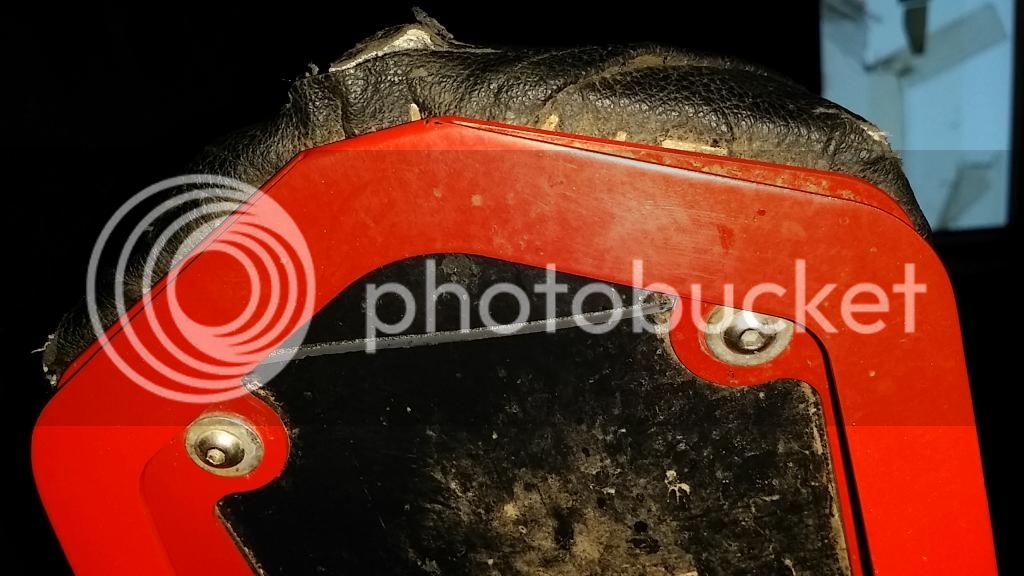

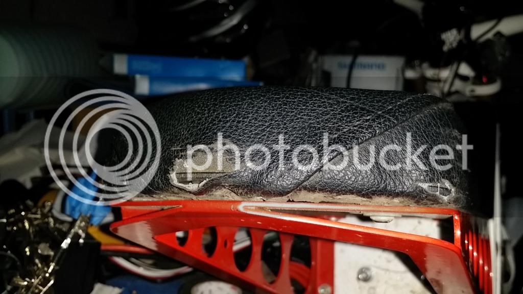

Cracked my motorcycle seat. I think this is mostly because of a design flaw.
The bottom of the seat seems to be plastic, which isn't a problem but this plastic piece extends past the metal in the rear.
I flip my bike around on its seat to work on my bike often, at least once per ride I will flip it in the grass to check spoke tension. I also flip it in my garage to work on the rear wheel.
At first this plastic piece cut through the vinyl seat as seen in the photos below.
To flip my bike around easily I found that if you hold the front brake and give it throttle you can easily flip the bike around, I gave a little bit too much throttle and the 130lbs bike fell hard on the rear. It was in the grass but I heard a crack.
The seat still functions because it broke after the screws. I don't know if this will cause future problems.
The problem, in my opinion, is the plastic piece should not have extended past the metal seat frame, this way if you flip the bike around it hits the metal seat frame instead of the plastic.
I guess I could have fixed this by removing the vinyl and trimming the plastic. Sometimes I wonder if the seat should extend further back more. Once in a while I like to sit really far back and wonder if it would have been better if the motorcycle seat was longer. This could just be me though and I would think the motorcycle seat extends much further back than the bicycle seat. I wish more of you used the motorcycle seat so we could give Qulbix better input into its design.
This is the first design flaw that I found on the bike and I have put over a 1000 miles of very hard riding on the bike.
The crack. The very rear part of the seat is loose here, only held on by the vinyl and possibly padding.
Here you can see the holes from the plastic piece cutting through the vinyl seat.
I don't think its a design flaw per se, because the frame still goes to the end. The question i am asking; is the frame flexing there causing the plastic to bend and crack after the screws, or is because the screw holes in the weakest point and the seat cracked because of that?
The plastic piece that sits under the seat extends past the metal frame. This plastic piece makes contact with the ground when flipping the bike around. I guess you can argue that the seat was never made to be flipped around all the time.
The metal frame is solid and there is no flex.
I mis-understood you Offroader, sorry about that. I thought you were talking about the seat plate breaking where the yellow arrows are, not the portion where the green arro is. My bad :| Somethign to consider, you can do this with or without repairing, but take some shoe goo and cover the area. The shoogoo will act as a chaffing barier. For years on my duty belt, my radio holder was chaffing evertime I got in and out of my patrol unit. I put some shoo goo on the bottom edge, last five years, no problems what so ever, I will take a pic of the radio holder and post it tomorrow so you can see what I am talking about.
