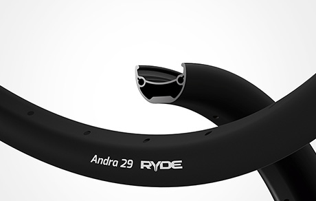

Speaking of stiff rims this one I am linking below would have been perfect for your cargo ebike:
Andra 29 - Ryde
The heaviest rim in our range, the Andra 29 was developed to stand loads up to 150kg.www.ryde.nl
It's got 29mm internal width, rim brake compatible, shader valve and the ability to order custom spoke hole angles for use with large diameter flange ebike hub motors.
Too bad it is not available in 26" size.
I'm surprised ebikes.ca doesn't carry that rim.Cool. Also too bad you can't find the Andras anywhere, and the sales person was a jerk to me. Very snobby.
