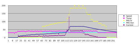

Why speedict measures cadence from 60 rpm?![]()
when i choose PAS mode (for watch my cadense) speedict shows cadence only when it bigger 60rpm, if cadence less 60rpm speedict shows zero.speedict said:sorry i don't get it ? can you explain ?evb said:Hi Danny,

evb said:when i choose PAS mode (for watch my cadense) speedict shows cadence only when it bigger 60rpm, if cadence less 60rpm speedict shows zero.

evb said:Current mode selected: PAS
Port 1: Speed
Port 2: Temperature 1
Port 3: PAS In
Port 4: PAS Out

Menu "option" -> "port status" then menu -> "record" -> "start record" then ..... "stop record" -> send email to youself or to us contact@speedict.com

I sent.
speedict said:hi evb,
by inspected your log file, i have found the number of PAS sensor magnet you entered "1" normally it is "5" therefore by calculation your cadence seem to be corrected ! can you tell me how many sensor magnet your pas sensor has ?
evb said:I have no PAS sensor, I have installed one magnet to big sprocket, 1 rotate - 1 impulse.
I measured by another device, speedict shows cadence correctly but starts show from 60rpm.

evb said:it means I used laser tachometer Tondaj DT-2234C for check speedict cadence measurement![]()
My installation is very simple - cheap bicycle odometer magnet installed to crankset sprocket, sensor installed on frame
I need to get cadence measurement for optimize efficiency of external motor, and it's very good you embedded this option in speedict.

Hi Danny, thanks. I will install PAS, I used bicycle odometer for cadence measurement before.speedict said:confirmed the odometer signal is different from our pas sensor detection method, why don't you install a pas sensor instead ? with 5 sensor magnet the resolution of cadence is much better than 1 sensor !
evb said:Danny, can you ask your engineers what's speedict method of cadence calculation?
