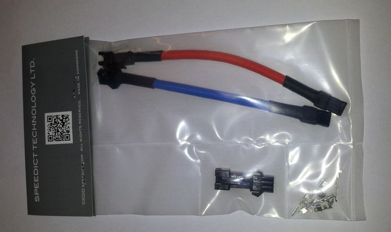

Wat Nico want is legalmode 2. And a option in the software That disable te pas sensor and the speedlimit only wit à button at the Phone and no need to change cables. I want that to.
When you see police you van change to legal, When police gone we can switch back.
Tanks for explain the cables now i understand the function.
Tomorrow i go connect them
of course we considered this situation, yes you can enable or disable any governor at any time ...
1. on road legal 2 mode, you can disable the PAS detection on "Motor start power" option, change from "6 km/h" to "Start Power" can release the pas detection restriction
2. on throttle type, you can change "speed throttle" (e.g. max speed set to 25km) to "current throttle" or torque mode so that you can avoid any speed signal over-ride, or even disable it
3. finally the top level of speed limitation - governor settings, on / off speed limit setting can cancel speed limitation
on previous firmware we have button called "panic button" a one touch button to enable or disable any governor settings ....
