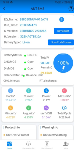

Houston, we have a problem!

I carefully inspected the spot welds (pro tip, you can get a sharp probe in the little slit in the nickel tab and measure the difference between the bus plate and the cell), and spent a day or so in denial, fantasizing about easy fixes.... Then had at it.

All the spot welds are good. Another little confidence booster.. The cells (unsurprisingly) measure the same at this point. So I'll test them individually and find the dud....
Gotta say, those big LFP cells look pretty bloody good at this point..... :-(

The other groups are fine. Charge it up and they all come back up to ÷- 0.025V. But 27 is definitely not fine! I'm working through it cell by cell. Unfortunately, I have another week away.. gonna get one of my guys to keep the testing going. Should have it back together by next weekend...
Battery testing is just about finished. Going to make a decision on what cells to swap this afternoon and aim to get the thing back together over the weekend.

After about 10 days of testing each cell there was only one that exhibited some self discharge. It's hard to imagine that it was soely responsible for the results we saw in the whole pack test.
What I decided to do is build a new P group (I had spare cells).
I had some nickel strip, but there was no way known my battery setup was going to spot weld that onto the 2mm copper. So I soldered them in with braided copper:
Not pretty but it went well, a bit of preheat on the copper and <1 second per cell.
I'm waiting for some glue to dry and manually balancing the pack, then I'll repeat the discharge test...
