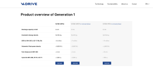

Their V21700-H50 could be interesting—though by end of 2025, there might be other interesting alternatives out there.
Let's see!
Interesting chart! I'm not sure how they're rating power density since the numbers on that chart are lower than their datasheet (UHP-26 has max specific power of 17kW/L pulsed). Designation also indicates only "High Power" vs "Ultra High Power".
We should see production 5Ah tabless cells with ~60-70A capabilities by mid-2025 with >5Ah pre-production sampling; it'll certainly be a tough market.
