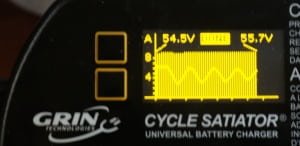

For those wondering about the charge graphics behavior, it works as follows:
Voltage Scaling = Vmax/2 to Vmax, with the max voltage being up to 75% of the screen height
Current Scaling = 0-4 Amps if profile is <=4A, and 0-8A if profile bulk current is >4A. Full scale is 60% of screen height
Horizontal Scaling = Time Axis, auto adjusting as the charge progresses. Time axis keeps growing for 30 minutes after Charge Complete is reached, and then stops
Both the starting voltage and ending voltage are shown on the top, in order to illustrate the voltage scale and let you know exactly where the charging is at. The text "DONE" will appear between these voltage readings when charge complete has occurred.
The plot above shows a 48V 20Ah Allcell pack initially at 44.5V volts being charged with a 7A profile. You can see the first 3rd of the charge it's at a constant 7 amps, then for the next 3rd the current is reduced to ~6A while the Satiator is in thermal rollback to about 330 watts on this hot day, and then the last 3rd shows the current decay during the CV stage, which ended at 54.4 Volts. Each tic bar on the time axis represents 15 minutes at this scaling.

It's probably just me, but that seems like a wierd way to do it, as it won't have nearly the detail it could have (not like it should matter much, but it seems like a waste of capability, especially if troubleshooting a pack could ever be done from the charging graphs).
I can't think of a typical pack that would ever be low enough at full discharge to be anywhere near half it's full voltage, so lots (most?) of the vertical real estate is wasted space if the lowest a voltage graph bar ever shows is half the full charge state.
Even a single NiCd cell would be more than half it's full voltage at empty, but that would be the closest I can think of out of things this charger would probably be used for.
I would guess that most packs are going to be Lithium of some flavor, probably 3s-4s "12v-16v" (lighting) to 12-14s (traction), and various setups in between, and on those half of vmax (full charge) is pretty far below what should be LVC for them, so not much of the graph will ever be used, even if they get discharged fully in use.
Couple of examples of my own packs to see if I am seeing this in my head correctly (assuming I did the math right...which I might not have):
Lighting pack 4s NMC @ 3.6v/cell LVC would be 14.4v at LVC, while full at 4.1V/cell would be 16.4V at HVC (vmax). So 8.2v for bottom of the screen, and lowest part of graph used for voltage would be 14.4V, just a bit below halfway down the graph, then 16.4V at the top edge of the graph. Unused range is 8.2-14.4v. Only about a third or less of the graph is ever used, the red area shown below.
14s NMC @3.6v/cell 50.4v LVC, 4.1v/cell 58.4v HVC. Half of 58.4v is 29.2v. Unused range is then from 29.2-50.4v. Maybe a quarter or less of the graph is ever used.

Hey Amberwolf, that's true, but there's also a tradeoff decision between graph resolution and having a graph that looks as we expect a voltage charge graph to look like. If we start with it scaling just at the starting voltage of the charge, and ending at Vmax, then the resolution is a max but look of the charge curve would always be some curvy line going diagonally upwards. I chose 50% of vmax knowing that most flat batteries would be at about 75% of VMax at the start of charging, and the resulting voltage plot would almost always be taller than the current plot, so the current plot is effectively contained within the vertical lines of the voltage window. Consider it aesthetics as much as anything.
The longer term plan (Version 1.1 firmware!) will be that you'll be able to scroll left and right across the plot graph with a cursor which would show numerically the voltage and current at that point, so anyone needing to use the graph more than just qualitatively could do so.
