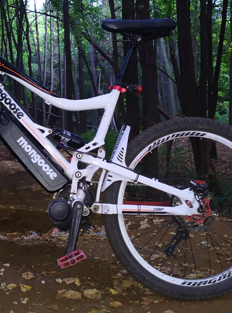

Continuation of tests 20.1c3. The battery wears out a little faster compared to 0.8. Normal temperature max 67°. But I did notice a strange unusual problem. Rather, it applies to full bikes. When we sit on the bike and support our legs (lowered saddle), swinging the suspension in hybrid mode and power assist, the bike runs away from the butt. The engine starts during a deflection of the suspension: / this problem appears to a lesser extent in the emtb and torque modes. I have a bicycle with a floating bottom bracket in which the pedals move backwards during bending. Many frames have a similar phenomenon, greater or less than. If someone has this soft loaded and the bike with full suspension, let him check it.
I was very troubled by strange engine jerking when I was driving around rock gardens and rtv/agd sections, a quick bend test at a standstill showed the reason.
I mechanically calibrated my torque sensor (range from 80 to 200) and installed version 20.1C3. I'm using 36V motor with 52V battery and display SW102. It's definitely the best firmware for this motor so far. I'm immediately a fan of the hybrid mode, using it with "Assist w/o pedal rotation" option, "Motor fast stop" is not enabled.
The motor response is super fast and hybrid mode works very well increasing power with higher cadence. With my setup the power goes up until I reach cadence 110, then motor starts to stutter. That is plenty enough for my riding. Field weakening is not enabled, but it didn't seem to make any difference to max cadence.
I have a full suspension bike and I have no problems regarding that, although the linkage is such that the bottom bracket doesn't move closer to the back wheel when suspension is working.
mbrusa said:
What is the setting of the "Assist w/o pedal rotation" and "Motor fast stop" parameters?
With full suspension bikes, it is better to disable them.
Assist w/o pedal rotation - disabled
Motor fast stop - I tried both settings on both the same. only faster the motor turns off after pedaling has stopped while this option is active.
this is how the suspension system looks like in gt

hetm4n said:
The problem you describe can be caused by a too abrupt stop of the engine or by the better reactivity at the start introduced in the latest version.
In addition to disabling "Motor fast stop", set "Motor deceleration" = 0.
Try to decrease the sensitivity of the torque sensor, see the calibration procedure.
Enter in "Torque adc offset" the value obtained without pushing on the pedals + 10/15, in "Torque adc max", the value obtained with the maximum weight on the pedal.
Enable "Torque calibration".
I hope it is decisive.
