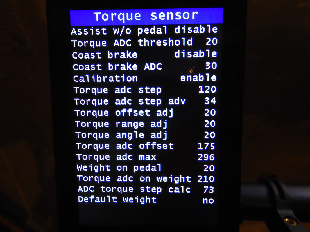

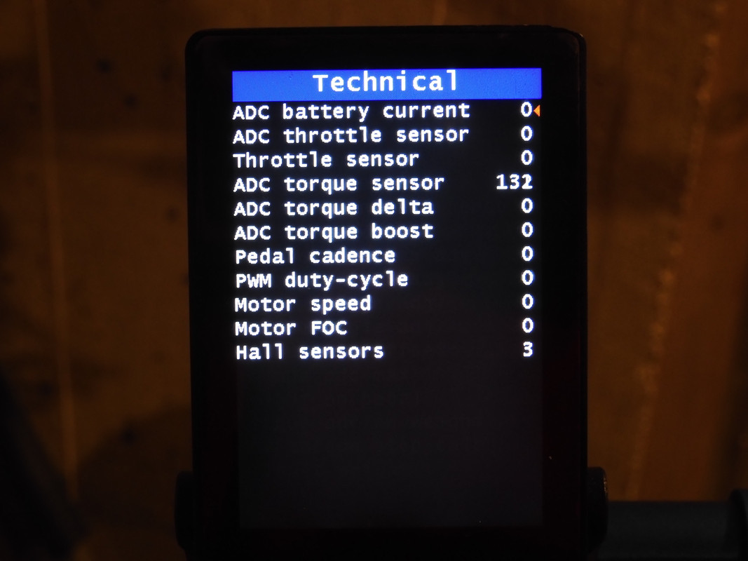

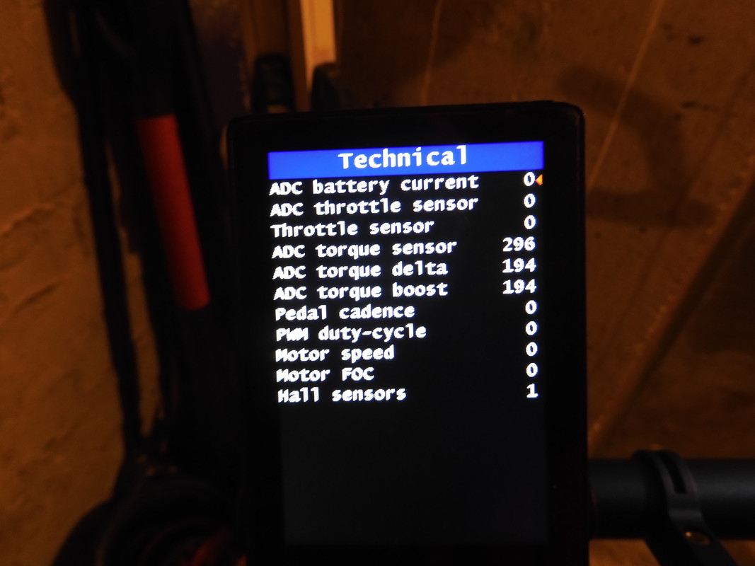

mbrusa said:Calibration enabled or disabled?
v20.1C.4 update 1 is on both, display and controller?
Post a photo of the Torque Sensor menu screen.
Then two photos of the Technical menu, with the bike stationary, one without pushing on the pedals, and one standing on a single pedal.
dameri said:mbrusa said:Calibration enabled or disabled?
Calibration enabled. I'll post photos tomorrow. Display and controller has updated latest version.
mbrusa said:Well, from the photos you can see the cause of e2 error.
"Technical-> ADC torque sensor" with free pedals, is 132, this value must be entered in "Torque sensor-> Torque adc offset", not 175.
"Technical-> ADC torque sensor" standing on the pedal, it's 296, value entered in "Torque sensor-> Torque adc max" is fine.
There is another wrong parameter, it is "Torque sensor-> Torque adc step", why 120?
It is not important because it is only used in Power mode with calibration disabled.
The value to be entered (estimated) with the right torque sensor parameters is 34.
This can be achieved by setting "Calibration" disabled and "Default weight" yes. "ADC torque step calc" is the estimated value of "Torque adc step".
Attention, with "Calibration" enabled, "ADC torque step calc" is the estimated value of "Torque adc step adv".

mbrusa said:Thanks for the confirmation dameri.dameri said:Thank you mbrusa.![]()
I switched calibration disabled and turned power off and on again. There were no errors on display.
I drove to the grocery store and turned the power off. When I came out of the store, I switched to calibration enabled mode and turned power off. Turn the power on again and there are errors in the display.
The cause of the e2 error is in a check added to v20.1C.4 update 1.
The purpose is to signal if there is a push on the pedals while turning on the display. It is active only when calibration is enabled.
In the previous version this control was not there.
Strange to have the problem on two different controllers, maybe wrong value of "Torque adc offset"?
In the next version I will increase the check threshold. In the meantime you can leave the calibration disabled, in your case nothing changes.
