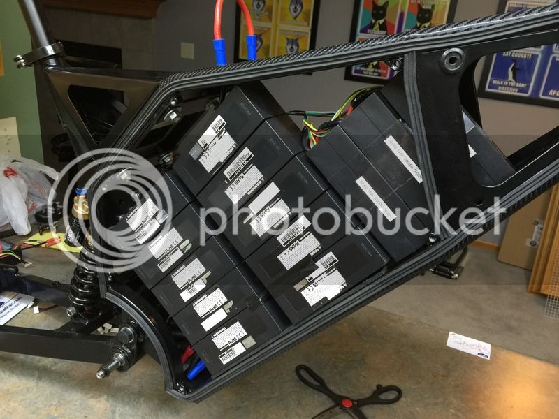

I am curious to know what kinda of battery setup is everybody going with. I had planed on using multistar 6s 16000 battery's but seem like there on back order and will be for a while.
Routybouty, I'd like to see pictures of how you fit your batteries in your Vector frame.
Here they are, it's definitely cramped. The BMS will probably get mounted to the Max-E vertically. At least wire-wise, everything should be mostly hidden.
Looking good.... that's a lot of lipo!
In this picture from the Vector thread the batteries are stacked upright, but there's a lot of wasted space at the top. Figuring out the best way to stack and secure the batteries is all part of the fun of building an ebike I guess.

I played with different orientations for a long time. I wish I had got one of the earlier 150mm wide frames! Then I could have fit 3 batteries wide standing or laying flat across. Oh well, it's pretty good "battery fill" I guess :lol:. I still have to cut a bunch of foam blocks to help support them.
That's awesome, I notice that these battery on HK are going for good price but is it possible to fit a 24s arrangement in there?
The max voltage you should go is 22s.
Why?
First, the adaptto starts to limit the power above 92V so abaove that you don't get the power the controller can put out.
Second, the FETs of the controller are 100V rated and when you run high phase amps there are voltage spikes that come from the motor to the controller that could kill the controller.
According to adaptto the optimal voltage for full power is 85/86V, so you should go for 20s or max 21s.
For example, i'm running 22S and i never charge above 4.1V per cell to commute but when i want to run high power i never never charge above 4.0 /4.05v per cell.
