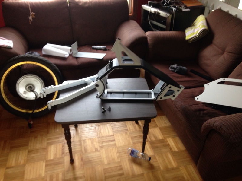

High guys, this is my first post on the forum and my second ebike build. i got the frame from Artur about 3 months ago and have been riding it now for about a month now after finally getting all the parts together and just love it.
This has become my daily commute to work which is 26km each way, weather permitting, and i have a total of just under 700km on it.
For now i will post a few picture of the finished bike, and later i will update the post with all the parts i have installed.

first step
front axle
front axle laced
almost there
porn
1.0 ready
I still have to change many things. This is the first version ready to ride.
Has Lyen controller. mxus V2, lipo 18s 2p 16ah. Dual disk brakes at front.
