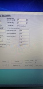

i have activated throttle release regenerative brake, the problem is, after change "rate of decline " value on page 1, the regen feels the same, whether it is 10 or 150. is there another setting should i activate or maybe another problem?
thank you.
UPDATE : Problem solved, by changing the EBS ratio value, usually only rate of decline value is enough.but now seems like i should also change ebs ratio too.
