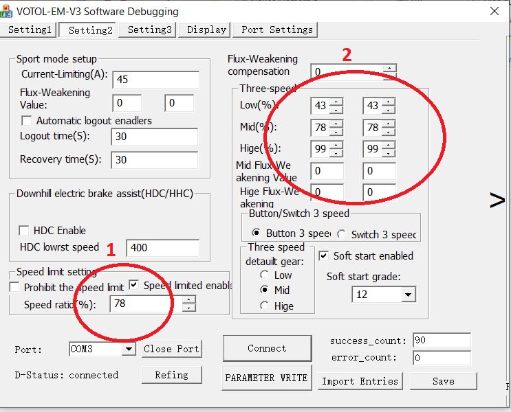

How about an external speed limiting solution? There are a few ways to do it.Can anyone recommend an alternative to me that would achieve the speed limit feature I require?

A variation on external speed limiting would be to use two (differently configured) Votols in parallel and switch between them. Provides redundancy if one fails. And USD$50 for an EM-30S is a bargain.
Does the controller actually have a beeper inside it or on it's PCB? If not, then it isn't making the sound.Is anyone aware of the Votol EM 150 controller emitting a beep for any reason, while riding? Beep is a soft clear scooter horn sound. I'm assuming it comes from the controller?
Why you don't use 3-speed for different speed settings?A variation on external speed limiting would be to use two (differently configured) Votols in parallel and switch between them. Provides redundancy if one fails. And USD$50 for an EM-30S is a bargain.
Unfortunately the 3-speed feature restricts current, not voltage or RPM.
The speed limit/downhill feature(s) limits RPM. I just can’t figure out how to activate/deactivate either of them on the fly.
I don’t know which ports to assign or what type of signals to use. Neither will work on the default sport and 3-speed ports, which are triggered by grounding the 3v yellow-white, green-white, and black-white wires.
