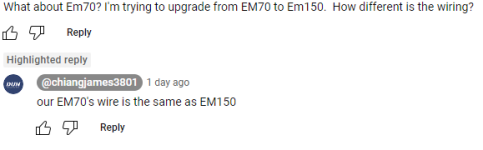

I asked this question of the good folk at Votol.net:
Ni hao.
I have a Votol EM70 controller. The Votol-EM-V3 Software Debugging does not have an option for EM70 under model dropdown menu. Can I use EM100 settings, or do I need a different software version (if so can you provide a link).
The reply from them is:
yes, you can use EM100 or any one. this option doesnt mean anything. you can also take reference from bellowing link:
Support - Zhejiang Huaqu International Trade Co., Ltd (varcheaemobility.com)
The link leads to a bunch of very helpful pdf support documents including votol error codes, manual etc.
The software compatibility was also independently verified by James Chiang of Dunn Controllers via this Youtube video question and response in comments (I don't know if they are a reseller, manufacture using that architecture under their brandname or if their product is somehow not identical).
I hope someone finds this useful
