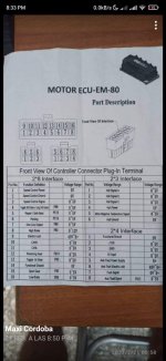

Hi, can someone help me wire this up please.
My old system was like this:
- In the first photo the yellow and red cables are for the physical key. White and blue for the screen.
-In the second photo: Red was the + of the battery, blue and green for each directional. I think the black went to GND, but when measuring the voltage it gave a lower value and when the brake was pressed a higher voltage, so the brake light was always on and when the scooter was braked it would light up even more.
-All my lights run on 60v.
- Finally, in the third photo are the cables of each brake.
-I also attach the screen model and the wiring diagram that my model has.
I really don't know how to connect any of these cables or the necessary settings in the software. Currently I have the front light and turn signals working but not the stop light or the display.
Thanks in advance

We'll need a fair bit more information to help you out, so there are questions below. When answering, keep in mind that more detail is better, and more likely to help us help you. ;)
Just to make sure: What exactly is your goal? What specifically do you need to be wired up, and what functions do you need it to have when complete?
Is the "old system" a different bike, or was it a previous set of equipment on this one?
What exactly did the old system consist of?
Do you have a complete wiring diagram of the old system? That would help tremendously in wiring up the new one.
Where did they connect in the original system?
Where the key is wired depends on exactly what it needs to do for you. Most often it is wired between the controller's lock / KSI / keyswitch / ignition / etc wie and the battery positive, when the controller has such a function that runs on that voltage.
Without the manual's definitions of each of the things in the wiring diagram, I would guess that in your case the keyswitch would connect one wire to each of the "Anti-theft" pins on the controller.
What specifically does the screen do in your system? Is it just an information display (if so, what information)?
Or is it a display that lets you change setttings in the controller, etc?
Did this display come with the controller you are hooking it up to? Or is it from a different one? If so, which one? (displays are not generally intercompatible with different controllers, depending on exactly what the display is and does).
If the screen only have white and blue, nothing else, then it seems unlikely to work if it is anything like other displays; most have at least four wires, some several more. Is it getting power or other inputs from other wires that are already connected elsewhere?
Well, the black couldn't go to ground if it gave any voltages at all. That's what ground is for, is a reference to be 0V to "compare" the voltages to.
Brake lights can be wired in a few ways, some of them use a common ground and some use a common positive. The switches might be wired between any of the lights and ground or positive depending on the brake lights themselves, and the rest of the system wiring.
What did the red wire connect to on the old system?
What did the black wire connect to on the old system?
Is your present battery a 60v battery? If not, you'll need a DC-DC converter to provide the 60v the lights use, out of whatever your battery voltage is.
I didn't see a wiring diagram for the screen, or a screen model, just a controller diagram and model. There is a picture of a display with a keyswitch below it, but that's all.
Which settings are you referring to?
Are these in the controller, using computer-based setup software? (or an app)? Which version of software (or app) are you using, and how is it being connected to the controller?
If you mean for lighting controls, the controller does not generally operate any lighting; that is usually done with external switches or relays.
If you mean for motor settings, that depends on your specific motor and whatever the controller's manual says to use for it, and your specific usage and conditions. (because you need to make sure the controller is set to not allow more power than the motor can handle, but still enough to do the job you need the bike to do).
If you mean for your battery settings, that depends on your specific battery, the controller's manual, and your specific usage and conditions (because you need to make sure the controller is set to not use more current than the battery can deliver, or go too low in voltage).

I'm sorry for the poor wording and confusions, this is a translation.
In short: wire display and stop light.
I mean the previous controller
It was a Chinese driver like this, in general they have almost no information even in internet
As i said it, to the key, when it turns they make contact.
it was a simple display, it only showed speed and battery charge.
It is the one that originally came with the motorcycle, I don't know which one it is because it had an identification but it was erased. That's the problem because I can't look for connection diagrams, otherwise it would be easy to wire
I think that for the old controller it was enough because the key cable also gave VCC and the blue data and the white GND? I don't know
I think it was a common positive system, since the turn signal switches were open and when they were activated they gave GND to the blue and green cables. The thing is, the black wire was some kind of fake GND. Normally between red and black it had 50V and when the brake was activated it had 60V. This is the part that I don't understand because between the red and the turn signals I normally had an open circuit and when I activated it I had 60V.
It is the same battery, in fact if I connect the black cable to GND I have Rear Red Taillight. But at maximum brightness, and it should be less so that when braking it lights up more
Yes, I was referring to the document with the controller pins so that you can tell me which pins to connect the screen and the rear light to.
I was referring to the "port settings" on page 4 of the VOTOL pc software, and if necessary activate the "low brake" checkbox on page 3 of the software

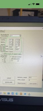

Ok I was able to figure out my 3 speed switch issue if not changing RPM and power. HDC was turned OFF and it was causing the switch to not make physical changes to the motor….turned it to “ENABLE” and now it does noticeable changes through all 3 modes.
My next question is, on the switch settings. There’s two columns. A left and right. From my understanding the Left side is throttle %? Like how much power the motor is pushing out on that mode and % but I’m not sure what the right side is…I believe a read somewhere one side is high voltage and one is Low. I see so many different values posted everywhere. I looked in the manual but the language translation isn’t clear to me on this and what a good value should be for these areas.
