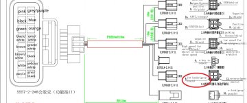

Got it working connecting with hall) last problem is making regen to work. I tried grey white (lowbreak) it shows as parking stand. Tried brown white (parking) it does nothing. Is there something in program to check for regen to work?
Normally regeneration is connected to the brakes. It is high-level and has a green cable at the 8th output of the plug.
I do not know where it is activated and how it is set up.

well low brake (grey black wire) is connected for regen. But when i activate it in "prorgam display" shows as side stand. this is why im confused, maybe this is why my low brake(regen does not work?
Strong regeneration is only activated by a brake, which means when 12 volts are applied at 8 pins by pressing the brake, it is activated.
There is no pin out for poor regeneration. It is enabled by default but can also be activated from the side stand. I'll check it tomorrow.
It's normal to have it in the program display as a side stand.
If you want to use high regeneration to assist you in braking, you must use the high brake level to pin 8 (purple wire), when pushing the brake handle you must apply 12 volts to pin 8 (purple wire) and this will activate.
Pin 16(grey black wire) is good for tying it to a side stand that, when activated, will pin 16(grey black wire) to ground. This prevents the motor from starting when the side stand is lowered and someone rotates the throttles by accident.

Thank you! this should be useful for others. Too bad that in diagram they mark it as low brake instead of parking stand :)
