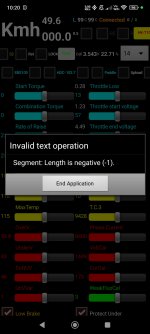

It also changed the values of maximum voltage and currentScreenshot_20250520_191141.jpg
When you connect, you have to correct the voltage if you use that app.
I try to change the parameters but the app crashes.
If you use it, can you share it?
Maybe my version of the app is buggy... 🤷
