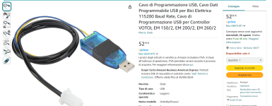

yes have original usb cable ...correct driver prolific too.The firmware are the same fron votol 35 till 100.
You need to pay attention to the cable, you put in the firmware WITHOUT CAN comunication. Have you the correct programming cable? Has you try to swap tx/rx pin?

Ok, I have alreade the same logic analyzer, if the mcu not respond, no way.no no my friend.... i im using special tools here like an logic analizer (from saleae) and can be sure that the MCU is not responding... the app send 4 times the initialize strings but no answer from the other side,,,,, i know about the prolific issue but it is not the case .... something is going on with the firmware flash or the BIN is not the correct one

yeah i checked evry box and switched rx/tx. yep i'm italian.Ps: are you Italian?

That's CAN/USB adapter, they all costs around 40ish euros. you dont find them cheaper@sugar0
Check device manager in windows. If it's a Prolific PL2302, you need to load a old driver (the one built-in in windows don't work with fake ones).
By the way you got ripped off with that price - a regular RS232/485 adapter cost less than 10€.
No, this controller is made only by siaecosys.Oh, missed the CAN-part.
Have you tried with a RS232 adapter?
