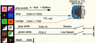

I want to share, I’m tired of disruptions, the USB switching off during operation, I’m sick of it... I connected the RS232 cable from the motherboard and through the MAX3232 то TTL output, connection and communication problems are over forever, even though the day is all inclusive, there is no failure. Windows 10 - 64x

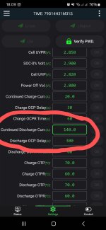

Mine does that on long, very hot trips in the summer and between 2 people.
My pag2 votol 150 qs138 v1 70h
Bms 5min 300seg max currect
140 current continued
