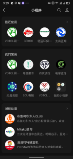

Looking forward to hearing from you, with my homemade Bluetooth module, It works partially with the first blue app in the picture, of course most fields are not adjustable, but the monitor screen works very well, you can try it
can you show me how to connect the controller to that app, it cant detect my hc05 module
Anyone can say the name of the Bluetooth app? I don't find it in wechat 😅
I use hc05 and the password is 1234, only read permission, not write permission.
I don't wechat, how can i try this app?, not seeing in Google playstore
Please create an account, it is not available on chplay or apk

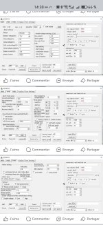

Bonjour les amies
J'habite en montagne, j'aimerais avoir plus de couple et de puissance pour rouler en montagne sans griller le contrôleur mdr
Y at-il une possibilité de faire évoluer le paramétrage de l'em150 ? Svp 🥺
Batterie supportée 220v max
Actuellement je monte une côte de 11% de dénivelé sur 4km à 90kmh

what hub are you using? how many kw? and temp after your climb?
