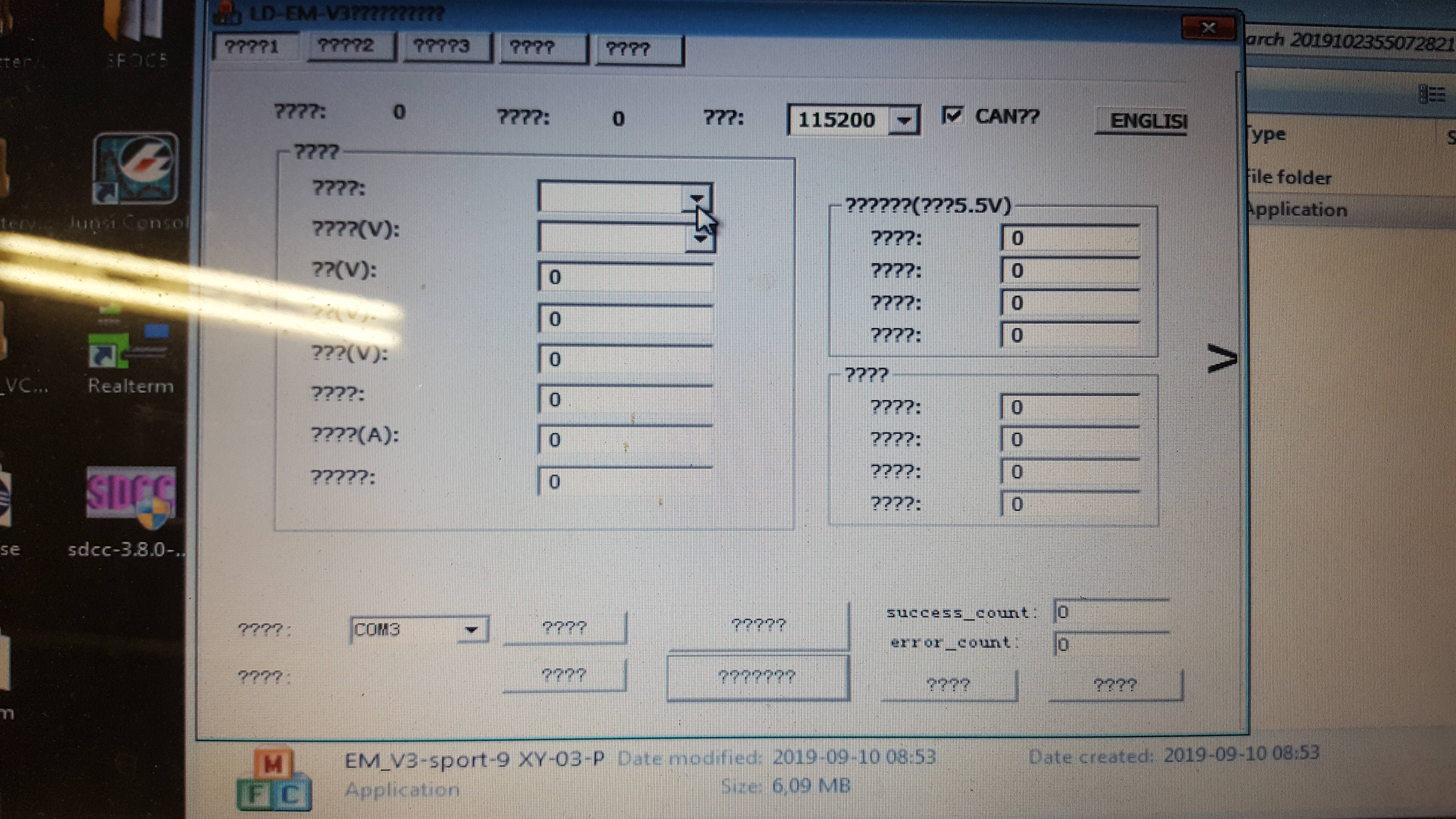

I am trying to use a 150sp now.
I have some problems with the computer software.
I have 3 versions. When I install them it seems fine, and the first time I open them.
But after that the 2 newer versions looks like this:
It doesn't matter if I delete it and install again, It doesn't even work the first time again.
I have tried 2 computers with the same result, both with windows 7
An older sw works, and I can connect:
But it dosent have all the settings the newer ones have.
I am rather lost when it comes to computers, so I hope someone has an easy solution :?
On the the top right corner you have "English" button. Click it and you will see the things normal again.
