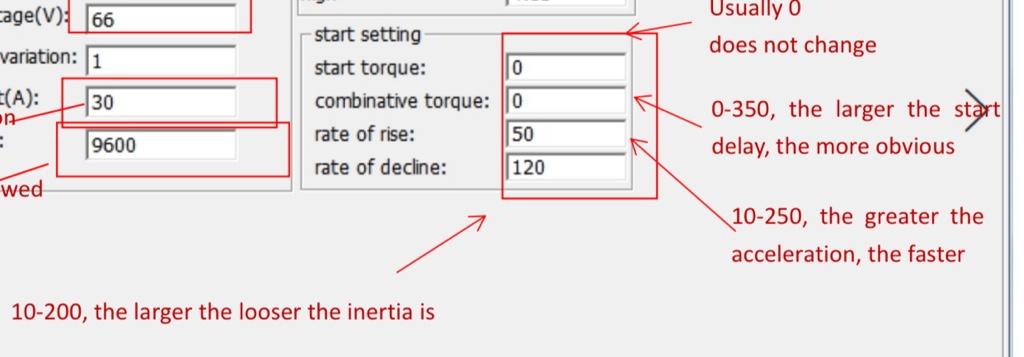

Pole pairs..
The old manuals something can shed extra light, although some things are obsolete with the hardware/sorfware updates.
This clip from the 2018 manual state the obvious, that the only thing pole pairs does is tell the controller the RPM of the motor, and then it uses that data in several areas. So if you have 5 pole pairs and enter 15, the RPM indicated will be 3X, and that may cause the controller to activate timing maps for that speed, or limits.
It also gives basic starting points for flux weakening based in motor type, magnet mount, magnet height.
It also warns that setting it too high can demagnetize the magnets 😳. So for my 500W motor pushing a lead sled i don't think i need flux weakening.

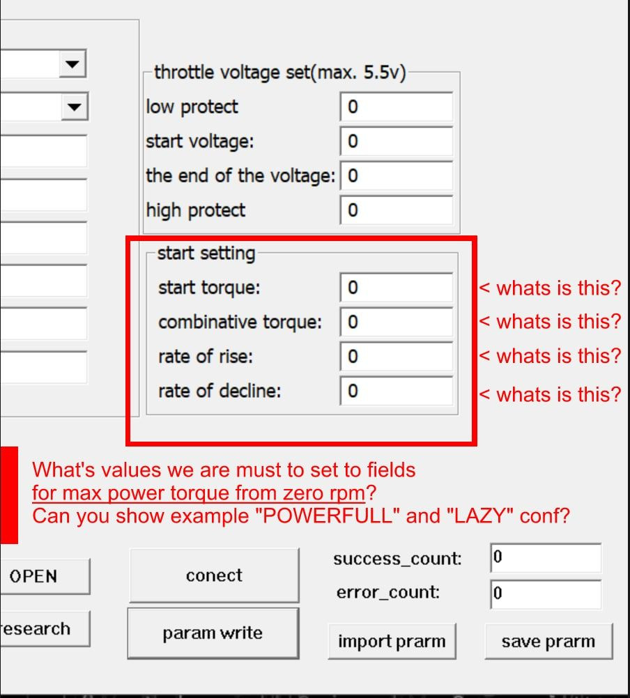

Hey!
What's settings must be here?
1) For maximum TORQUE POWER from ZERO RPM (VOTOL EM-150SP)
2) For normal DEFAULT TORQUE?
Cheers.
maincraft said:
Hey!
Cheers.
start torque 0
combinative 0
rate of rise i put the maximum 250
rate of decline i have no idea what it is , i let it to 80 untill i know
