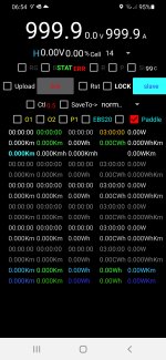

Samsung galaxy A40 2340 x 1080 (FHD+)
demo 5 & demo 4 the same display!
Old Nexus 2013 fullHD all OK!
The default font size in the smartphone settings.
The next from the minimum font size in the smartphone settings.
The minimum font size in the smartphone settings.

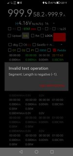

Hi, Thanks for reply.
OK, I understand this issue. I'll detail with it on Holiday.
'cause I prefer use all setting on one screen and Font size is minimized. So I need adjust proper location to fit smaller screen.
BTW, can you connect controller successfully by BT or found some issues ? Please let me know.

Update more compact display APK
View attachment em150_demo8.zip
Unfortunately, the "demo8" version doesn't work for me.
Immediately when connecting

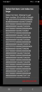

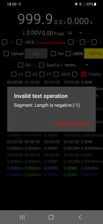

My diy Bluetooth adapter hc-06 speed 9600
Version "em150 test" no problem.

Since debug info cannot point out logical failure of APK inventor. And I do clean a andorid phone to factory reset status, then test demo APK. Since not found any error. So maybe there's some different in your phone or controller infect the APK.
SO pls try these debug, you can tell if they work with or without fail-hints. thanks
View attachment em150_debug1.zip
View attachment em150_debug2.zip
View attachment em150_debug3.zip
