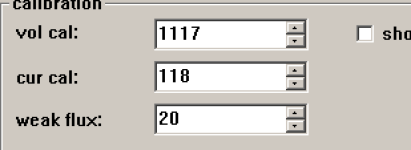

Changed the overvoltage, everything worked!
Voltage and rpm are still displayed incorrectly!
Your default value is:
Please change the wrong value to 1117, 118, and 20. Then controller will send correct Voltage, not 83.4V.

Shouldn't these values be read by the application from the controller?
Yes, but maybe last version of APP changed your setting. So you may manually change it back, and this APP will memorized setting on your phone.

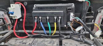

Hello Guys,
Is there compatibility issues with Votol controllers and Hub QS motors?
In a Gadiro e125, it uses Votol EM50 + Yuma Motor 3000w, its performance is very good like 100cc motorcycle.
But I have a Hub QS motor (3000w, 17", torque winding, 45h, iron core, 30 pole pairs). The performance is VERY POOR, like a 30cc motorcycle, super sluggish acceleration and almost NO TORQUE. Of course I did every settings, correct hall shift (also tried 180, 120, 90, 60, 0 -60, -90, -120, -180), pole pairs, field weakening settings, change hall/phass wires, field weakening calibration etc.
Also tested with 2 different Votol em50 controllers (one votol em50s and another votol 7280s transparent cover).
I fear there is compatibility issues and have the same issue with votol em150. The motor works well on other brand controllers.

For Votol controller, you may try swap phase wire to your Moto phase wire (about 6 combination). My status is solved by this way.
Remember you are finding smooth torque, then you switch wheel direction with controller BG-swap or YB-swap option.

Thanks for repply, I already tried changing phase wires /hall wires. Motor runs smooth but no torque. Even a 1500w citycoco has more acceleration than me.
I suspect there are some compatibility issues with QS motors, if its high pole pair numbers or winded for torque. I've seen another guys with such problem but they all went for another controller

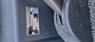

This motor came with the bike, the brand doesnt give details. But its iron core, 45h, 30 pole pairs. Yes I did test with the spare hall connector and the result was the same. Ive tested with both Lande Votol 7280s and Votol em50s. Next week ill test the em150, If no torque remains, then I go for fardrive or lingbo

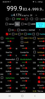

Try these settings:
Also if you have a BMS that reports current or a clamp meter, verify the current shown in display page agrees with the other current reference. Some people try to fool the controller into giving more torque by messing up the calibration and it gave really bad performance and the motor ran hot. The factory calibration should be good so if you changed it then you should change it back.
Also you can try to set flux weakening at 0 and set HDC rpm just below the flux weakening rpm. With the wheel off the ground as you accelerate it should be it’s quietest before flux weakening tries to kick in, then above that it will begin to sound frantic.
You can try to adjust the 600 up or down in increments of 50 between 200-1200. Currently you have it set for 2000. This us kI (Integral constant) of the current loop and if set too low it will sound like you ran over a rumble strip and if set too high the motor sounds frantic. As low as you can go without rumble under full acceleration is best.
When you give full throttle does your battery current go up to 60a? Or the Votol display current shows 60a during max acceleration?
Once you get it working best without flux weakening you can increase HDC rpm in stages and add some flux weakening in stages to get best performance.

Hi, i have a UMI ym2000 electric car with votol em-100 controller and a 2kw motor and does not run with more than 17km/h. Any ideea of that? Has happened to any other from here?
I don't know what model is the motor.
I think that has a 60v lead acid battery so the first thing to check is the voltage stays above 65v under load. It will show 73v when charging, then 69v float charge, then 66v after unplugging the charger. But it the batteries are old and neglected they will drop very low as soon as you put load on them.
That car should go 45 km/h but the Votol has a soft low voltage setting that will limit max speed and current about 10% for each volt the battery decreases below the setting.
It would help if you get the debugging cable and show the settings.
If the battery is good we need to see the controller settings.
Solved, seems like if you put pin 11 and 12 (the orange cable in the last picture) toghether you will have "low gear" wich means maxim 25km/h.
