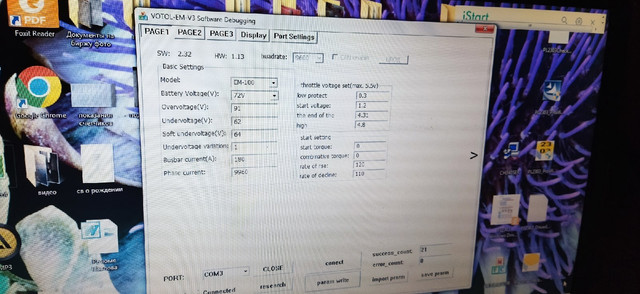

I have the following issue with my Votol EM-100 controller. Have screened most of this thread but nobody have had the exact issue.
I have upgraded my moped with a brand new 3kW QS motor, new Votol EM controller and a DIY 60 V 45 AH battery.
The current obtained speed (unloaded) is only 10 km/h. The reason being that the controller has been configured by QS motor company for 72 V battery.
I have tried to change the battery voltage to 60 V inside the software. However I cannot param write the change. Upon pressing the param write button the software says that the change is made successfully. But that's not true when I restart the system.
It appears that Model number and Battery voltage (red square in photo) in the drop-down menus can be changed. Anything else (i.e. overvoltage, undervoltage etc) refuse to change when controller is restarted.
Anybody have had a similar issue and a possible solution? 🤞🏼

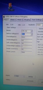

In my debugging software, the settings for over/under/soft under voltage, automatic are changed. If I change the battery voltage. (without saving)
Thanks for reply.
It's the same with mine. When I change the battery voltage, to 60 V, the parameters below (overvoltage, etc) do automatically change, similar to your screenshot, but when I param write and restart the controller, the battery voltage would show 60 V but the parameters below would go to old values corresponding to 72 battery voltage.
What about the secure boot setting? I remember a warning about this? Never turned it on. And in the calibration mode, the setting "brand:", page 1. For me, common! Maybe a preset that's different for you?
Secure Boot is unchecked. Not sure where the calibration mode is and how to activate it. Is it the one to the right side? Increasing the throttle under remote control gives no response.
Also can't find the setting "brand" that you mention?

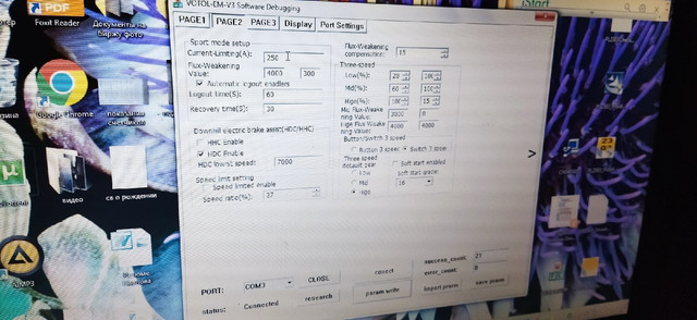

hi, does anyone have any idea what setting is configured wrong? The problem is the following - in the 1-2-3 speed mode, the maximum speed corresponds to the setting, but there is no power - the maximum current in the ant application is 50A, it no longer gives, the sport mode is now working fine and allows you to go to its fullest.
Votol em150s qs138 v3.
So you are saying in sports mode it goes up to the 250a you have your 150a controller set at?
If it works in sports mode but not in speed 1-2-3 try changing all 6 of the boxes for 1-2-3 to:
100 100
100 100
100 100
Your settings, although very strange, should work at 20% speed 100% torque, however it will only last a second to get you up to 10 mph. But set to 100% it should give you full speed and plenty of amps.
Some Votol it seems the second column is the 3-speeds is useless and follows a gentle acceleration ramp up. You can test it by settinf speed 1 to 100/100 and then set to 100/20 and see if torque changes.
BareKuda said:
100 100
100 100
100 100
This is em150s, according to 1 table its maximum current is 220a, according to the second 250a. In sport mode, acceleration is 0-60 kmh 3.3s. it’s bad that I don’t have the habit of maintaining good settings, since before that I drove 3000 km and everything worked correctly, but with the onset of cold weather, it was necessary to turn off the regenerative brake. And at the same time, my hands are reaching out to change something else)
who cares, reduction 13 \ 56, the maximum speed in sport mode is about 100 km / h

Hello. We use Votol 150s and QS 3kW with reduction in EV project. Is it possible to achieve engine brake assist in such way that QS rotates with lowest RPM counter clockwise?

I have a Sur-ron bike with stock mid drive motor, 60v70Ah battery and EM150/2 controller. Up to the point when I disconnected the battery to charge it at home, sur-ron run without problems. When I put the battery back, I noticed that battery voltage is displayed incorrectly and the wheel won't spin. It turned out to be a short cut in the rear light wire. I cut the wire and the problem with the wrong voltage disappeared. However the wheel is still not moving. In fact it moves a bit an then stops. Diagnostic software shows Hall Fault as well as Motor Hall faul. I have disconnected pretty much everything also checked another motor, but the fault is still there (it appears when I move the throttle). Battery is fine. Since my bike run fine before I suspect that the root cause is related to the wiring (short cut, weak connection, etc) but I don't have any more ideas how to troubleshoot it. There are many experienced people in this group so I hope that some of you may help me and advise what I can do to troubleshoot the problem.
IMG-20221129-WA0000.jpgIMG-20221129-WA0001.jpgIMG-20221129-WA0002.jpgIMG-20221129-WA0003.jpg
