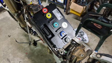

Got a fardriver 961800 to replace the apt 96800. For anyone interested it's significantly smaller, is 4.5kg where the apt is 6.8kg and i had to get it made to suite an encoder instead of hall. Going to need to remake the controller mount, probably a few weeks till going, will be sure to re-dyno.

Should be pretty good, I suppose we'll find out in about 2 weeks when I finish fitting it. I also need to do some other work to get the bike ready for engineering.

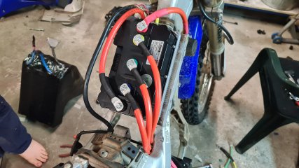

Fitted the new drive today, was easier than anticipated because it was smaller. Also replaced the phase and batt lines with some 50mm2 double insulated high temp orange cable for adr compliance. Much nicer then the factory motor phase wire which is stiff and unruley.
Got the basics wired in and did some testing. The controller doesnt like my precharge circuit, maybe a bit slow. It beeps a phase shorted error until i power cycle it with the contactor pulled in. Ran the auto tune and tried to ride it but it would stuttor and cut out with a phase current protect error. Halved the line current max and can ride now with progressive throttle but it accelerates very slowly with a max of about 14kw and aggressive throttle at low speeds still trips it. Im guessing its something to do with the PID params. Ive only used the app so far, will plug it into a PC and have a chat with it. The pc software looks a bit better fleshed out.

Update, went over all the settings with the PC. Some were out according to the manual so i set them to recommended. The default mode is "middle" if low or high are not turned on which explained the sluggishness. I set the bus amps to 600 and phase amps to 1200. Now it peaks around 45kw out of the batt :twisted:. I will get it onto the dyno for some tuning. The rate of increase in power is pretty slow. I believe thats to do with the control PID params. Motor didnt get more then 30deg, phase wires are just above ambient.

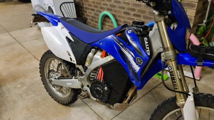

New rims arrived, fitted up some smoother tires. Last day of drag racing until sept tomorrow so ill take it down and see how it goes.

Good news and bad news from the drags. Yes, this thing rips. Did multiple 1.9s 60 foots and best time was a 13.6 @ 140kph. Field weakening is definitely active and working. Bad news is i had a bit of a stuttering loss of power in the mid range, not sure why. Moved current limits up and down but no cidar. Last run i upped to maximum instead of limiting it and it died while crossing the line :cry: . Something has gone bad inside the battery. I originally build the pack for 300A peak. Im guessing ive cooked some of the small copper links on cell 4. Will have to cut it open and autopsy. Still, damn thing will power wheely half way down the strip if i let it. Thats with 11/52 gearing 8) . Ill fix the battery, set it to a peak of 300A and be content.

Well, maybe a touch more now and then :twisted: . Throttle ramp is good. I pulled multiple 1.9s 60 feet on pretty tall gearing. My last run when i blew up was still a 14.0 @120kph. Short track really good on this bike.
