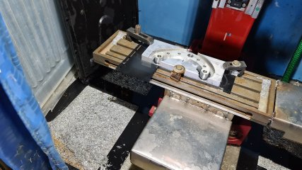

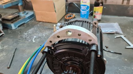

could you show more pictures of your motor mount? my motor arrived today and im doing a direct drive like you.
Hi Mate, these are the only 2 I dont think I posted earlier. I basically machined supports to go onto the swingarm pivot which then went to threaded rod going all the way across the motor.
Its not a particually good solution if Im honest, I ended up removing some of the cooling fin closest to the threaded rod and the aluminium ends up pretty thin between the threaded rod and the motor. I then just support the front of the motor in a similar fashion with threaded rod. Because of the ADR requirements I cannot modify the frame without it becoming significantly harder to get registered. If your just doing a dirtbike then I would probably get a mate with an AC tig to help you put more appropriate mounting points on the bike.
I would also not dismiss the jackshaft out of hand, having the primary reduction will mean stock rear sprockets but it also will allow you to move the motor forward to where most of the conventional motor mounts are located.
