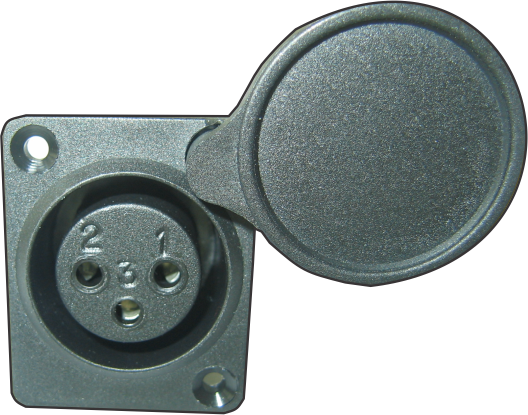

I would like to use a conector like this
To use the eaton 1800w to charge. What other options are you ussing?
I saw some time ago a cover that was posted here for this conector so no water could get inside but cant find it any more :(

Hi Chucho, I would purchase the 8 pole version so you have the versatility of paralleling poles if you run more amps later on. Easier to start that way.
Regarding the covers, be careful about which covers you purchase. I have not found a cover that works with the slightly larger sockets that have 4 screw holes. I bought the wrong ones (for the lighter weight versions with 2 diagonal screw holes) and these gaskets and plugs are too small. I haven't found a plug cover that fits and keeps water out yet.
If you DO end up getting the smaller 2 hole version (smaller hole to cut in the bike frame), I can send you some gaskets for free as I will never use them and it is too late for me to return.
EDIT: Nevermind, I see you are in Spain Chucho. Cheaper for you to purchase locally. However, if there is anyone in the U.S. that wants the Neutrik gaskets, I have a bunch that they can have for free but I still recommend using the heavier duty plugs and just make cut your own gaskets.
Using this XLR with dust cover for my Eltek flatpack @ 53.7v 30A (37A available). Tighened the spring on the back and I've yet to get water ingress, with 'sunny' UK weather :wink:.

Yes, i am going to buy 8 pole (i think i read it from you sometime ago :wink: ). Thank you for the offer, lets see if someone else need them. If you find any cover someday please contact me by MP so i dont miss them.
I have found this
but i dont know how good would they be :|
The smaller version of 2 hole is also 8 pole? I wish i was at USA Everything is more expensive and hard to find here.

If you are going down the neutrik speakon route (which you should) use one of these covers http://www.neutrik.us/en-us/speakon/speakon-chassis-connectors-accessories/sccd-w
thats a neat looking cover. id not seen it before.
so will it fith the nlt4fx type sockets?
i have used the 40A version for charge socket, I was a little hasty to get the plug soldered up and made a pretty crap job of it, as i needed to show the bike to a potential customer in 15mins :lol:
I think it may be cause the solder joints were done in a hurry, but the plug was around 55-60C (Hot to touch) after charging at ~30A psu current for 15mins.

Erik, I don't think that cover will work for the NLT4FX. I am still looking for a cover for the NLT4FX and NLT8FX plugs... Right now, I am using a rubber axle bumper that came in the protective packaging for my kids power wheels. Whatever works for now, lol... :)
It all depends on what socket you are using, NLT4FX is a plug, what sockets are you using on your bikes, that cover will fit quite a few sockets that will accept the NLT4FX but it depends on which one you've installed

http://www.neutrik.com/en/speakon/stx-series/nlt4mp-bag
It will fit this though
http://www.neutrik.com/en/speakon/speakon-chassis-connectors/nl4mpImageUploadedByTapatalk1451092860.140101.jpg
Although the current rating is a little lower, it's what I'm using @ 30a out of my eaton,
with those lower rated 30Acont sockets, what temps do you get charging at ~30A psu current?
just trying to find out if mine gets hot cause of the bad solder joints or if the socket is over-rated...

Others have noted that the sockets are overrated. That is why I paralleled mine on the 8 port.

The Eltek FlatpackHE2 is very quiet, the electrical charging whine from the motor (v3 Cro) is much 'louder', relatively. It's still quiet. Charging twice daily (total avg 2500 - 2600 watts @ 19C ambient) with the XLR and not had any issues with the pins melting the surrounding area, thats with the 30A Coil, Mini-E and 26S of A123 inside a none ventilated Vector frame. Although I have passive heatsinks mounted on both sides of the Mini-E that protrude 3mm through the side covers much like this, if the pebble dash wall is the panel and the fins that of the heatsink.
Like others, it seems I under-rated the charging feed cable and at 30A it does become quite warm to touch. This is being corrected with the remaining 12AWG left from the HS3540 with cut phase wires.
