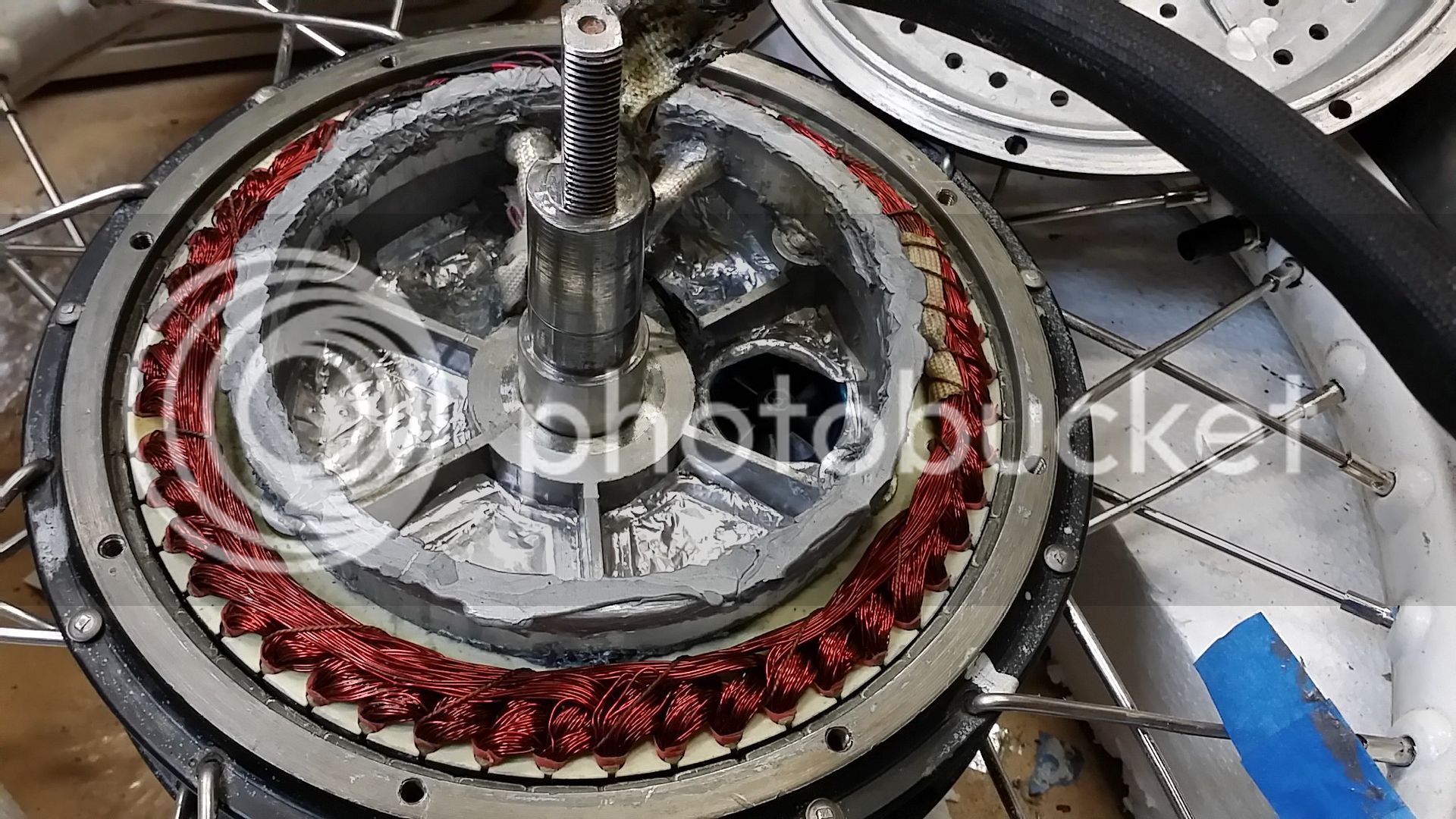

Got some heat problems with my cro motor v3.
It al starts even in the eco mode. Temp. rising towards 50 C.
In the normal mode temp. is going toward 90 C. And in the boost 120 A- 250 A it's going toward 135 C.
I did a few auto runs but have still the heat problem. Further is the Raptor a beast but I can't ride long with these high temp.
And that is just a waste of FUN.
Ho had the same problems and solved this heat problem.
The only way I solved my heat problems is with a custom cooling modification. There is no way around this heat problem unless you cool it. I went from not being able to ride the bike after 10 miles due to heat to riding as hard as I want when I turn on the fan. It works like a hair blow dryer when the fan is on.
120 Amps is a lot of power, you're going to heat that motor up in no time.
Is the fan instaled inside the motor?
I was no able to spot it in the video.
Do you have it on a build tread, because I think this is going to be the only solution for my problem, I think.
If somebody did a good job for solving this problem why not copy it. (if he's nog angry for that)
The way I built mine was on the difficult side, so unless you want a project I wouldn't recommend doing it. You will have to install an RC EDF to get good airflow.
The hard part is sealing the motor on the inside (the airduct) so the fresh air comes in, circulates around the motor and the hot air exits. The seal on the air-duct has to be good or you will just recirculate hot air inside the motor.
In the diagram below, I believe it was created by main88, you can see how it works.
You could try Ferro Fluid as an alternative. I am not sure how well it works, especially if you are pushing the power you are, but people are liking it. It is hard to believe it can cool anywhere close to my setup, because the amount of hot air that is blown out of my motor is surprising, it will burn your hand after a few seconds when the motor is hot.
