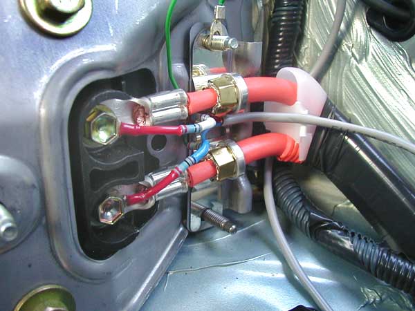

Chalo said:
Properly crimped wires can loosen, corrode, or both. Crimped and soldered wires can't do either of these things.

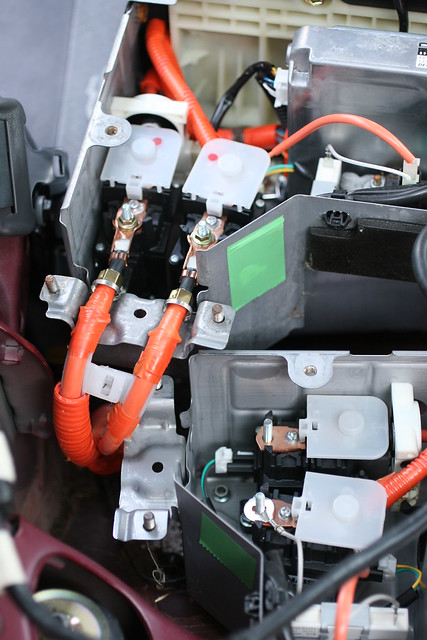

Chalo said:
"Cold welds"? I think you mean "points of contact". I have never had any problem prying open and teasing apart the strands of anybody's crimped connection when I wanted to. Ain't nothing welded about it. It is somewhat compacted, but permeable, and therefore corrosive liquids can get in there and corrode it.
Anyone who has dealt with factory electric crimps from a car knows that even quality inspected industrial stuff can loosen and corrode under adverse conditions.
Gen 1 prius main battery lugs
Gen 2 prius main battery lugs (ultrasonically welded??)
Insight
If you were to try to "disassemble" any of these professionally made (or any other properly crimped) connection you would find it very tough going.
Nobody uses solder in these kinds of connections. Solder wicks into the strands of the wire, creating a point at which the wire will fatigue over time. This is guaranteed failure!
Also solder is a crappy conductor itself, causing additional resistance in a soldered connection
The failure mode of a soldered bullet connector will likely be the solder melting followed by disaster. In an anderson connector the plastic housing will soften causing the springs that push on the contacts to spread apart. Followed by disaster...

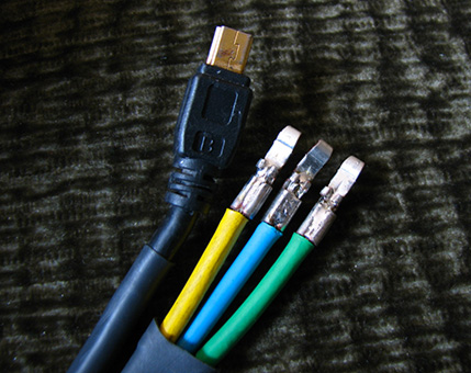

I use the USB Mini-B for the HE signal connector; this assembly allows me to remove the mounting hardware from the axle.
I haven't found a suitable barrel connector that allows me to replace APP contacts for Phase connections. However most of the time these connections are problem-free because they are well-secured.
Good enough and certainly better than what I had (which was stock wiring).
