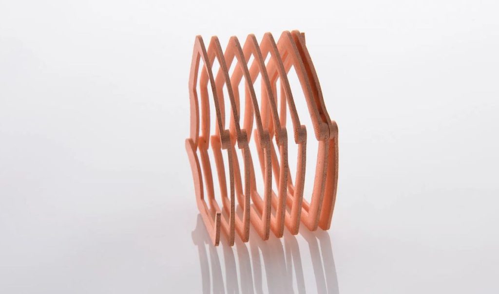

Teasers...
definitely use a single piece stator with single coil and flip your coils 90 degrees.
perhaps use square wire high density coils wound on a bobbin (perhaps mould the bobbins yourself)
Alternatively, 3D print coils if there was a group buy/build project. Can be potted using silicone moulds to make modules for assembly.
These coils can be made similar to edge wound coils illustrated below but with several benefits...
Yasa uses edge wound coils using a high speed CNC bending machine... you can see a it of it at about the 50 second mark of this video that was released just after Mercedes bought Yasa.

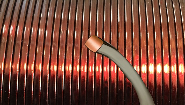

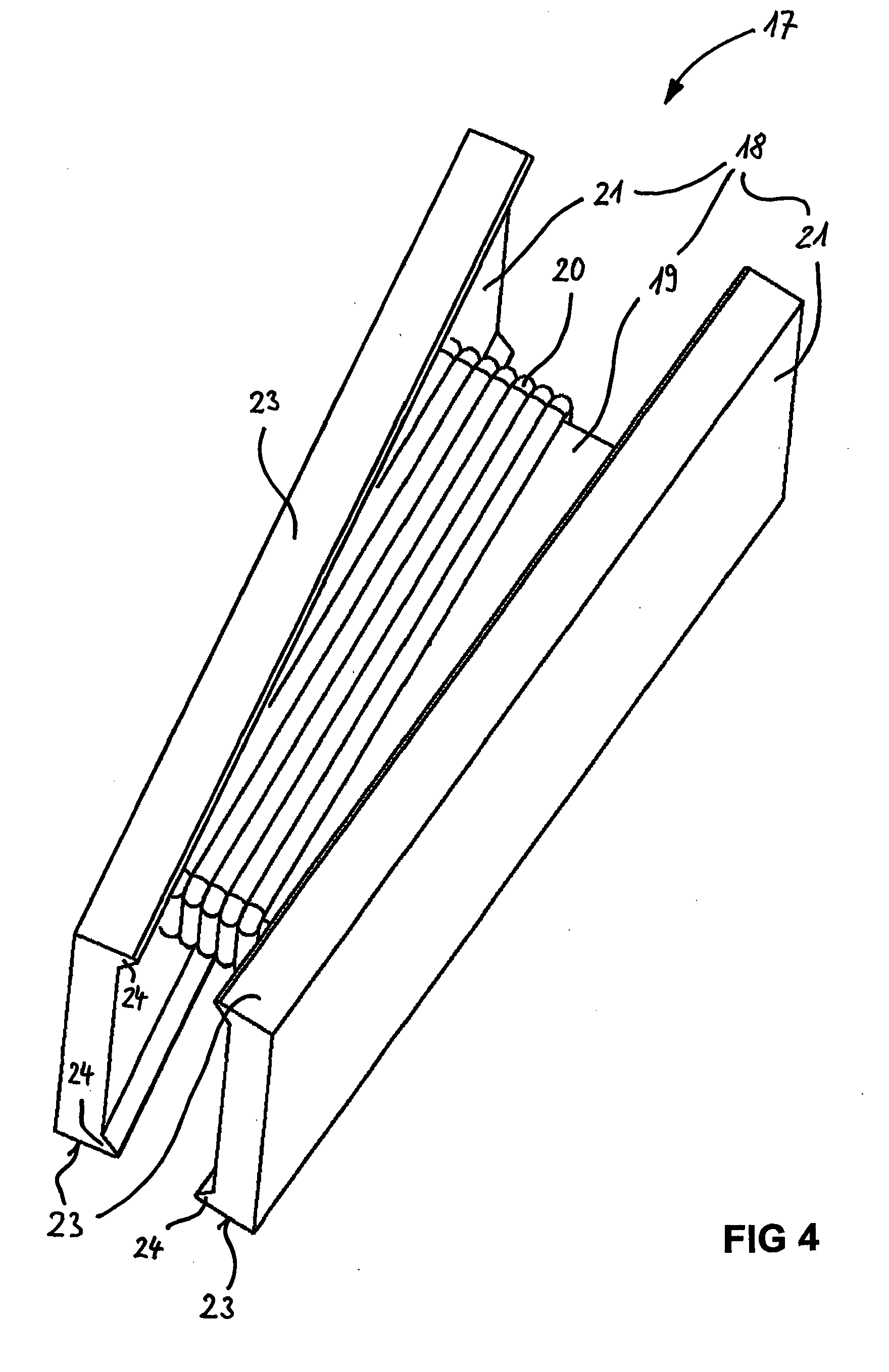

Mass produced toroidal coils (with very high fill density due to the use of square wire) are wound onto plastic bobbins. The wires from the coils are soldered onto a narrow PCB board, which have long pre-bent coil outlet pins soldered onto them.
AM-JKLWIIqD_IPTJhyAUPrrI448hVbnGcka4EmDAy5mGCk0nRF6SizKC7vakGEFEEiuFvmIi5vM3RE65MCodmmDC-5-F2JOMMOAvufU9Df6ocpSEi7t0PENv5r1v7QqzvUnP1Axzgu3QEHxIeoWx0Vz0zfs2=w738-h498-no
The coil output wires are soldered into a separate pcb board that bring all the coils together into the desired connection arrangement...
The coils are wound onto plastic bobbins that are sixed to fit snugged very tightly in between 2 stator poles with a hole in the center, all of which slide onto a split ring to hold everything together. Due to the design of the stator poles which virtually surround the coils they capture all of the magnetic field from the coils.

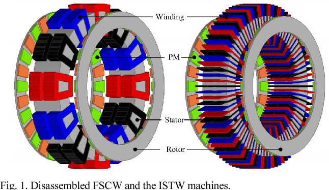

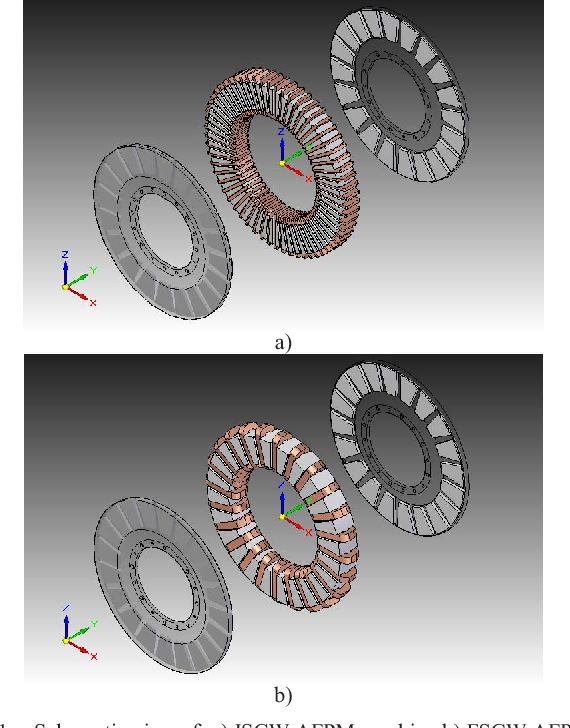

If you want to attempt a yokeless design here is a paper on the Comparison and Analysis of Stator Plate Holder on Yokeless and
Segmented Armature Machine from the Journal of Physics: Conference Series:
A F Desanti et al 2020 J. Phys.: Conf. Ser. 1577 012039
https://iopscience.iop.org/article/10.1088/1742-6596/1577/1/012039/pdf

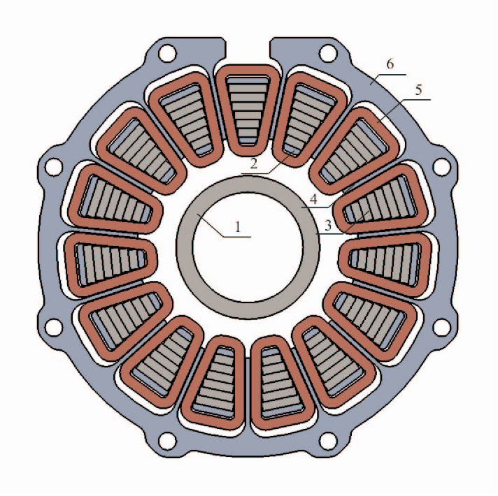

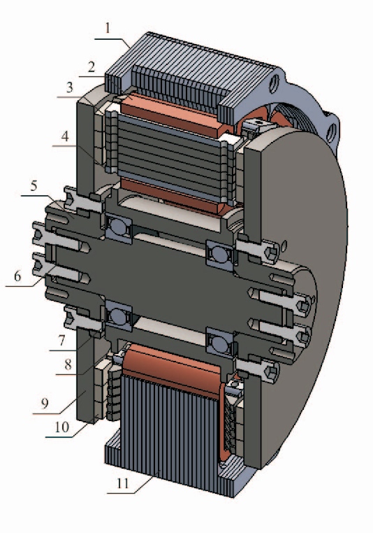

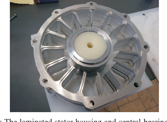

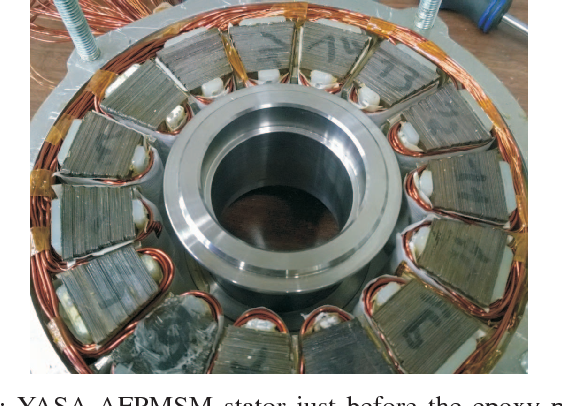

and here are the best images I have found on a YASA design
plan view of a motor shell lamination showing the stator holding arrangement.
Before the stators are put in place and potted with epoxy.
and here is the post potting pic
The above images are from the following paper:
Stator heat extraction system for axial flux yokeless and segmented armature machines
H. Vansompel, A. Hemeida, P. Sergeant
Published 2017
Materials Science
2017 IEEE International Electric Machines and Drives Conference (IEMDC)
pay per view paper.

HH I found another incomplete patent document but completely in English (yay!) but lacking the images (Boo!)
https://patents.justia.com/patent/9438092
Between this new document and Figure 4, we can see definitely that the new design split stator pieces must have a core thru the coils. The old design must have used a one piece yokeless stator which a traditional coil was wrapped with normal magnet wire. I surmise that they may have had manufacturing issues that led to the upgraded design choices.
FIG. 4 furthermore shows that the coil core 19 has two mutually opposite pole bodies 21 at its opposite ends along the coil axis, which runs through the coil core 19, to be precise in the center of the winding from the coil wire 20. The pole bodies 21 extend in the axial and radial directions in relation to the axis of rotation 13 of the rotor 12 (not illustrated in FIG. 4; the alignment of the coil elements is shown in FIG. 5) beyond the coil core 19 on both sides. In other words: both pole bodies 21 of a coil element 17 protrude on all sides beyond the coil core in a plane perpendicular to the coil axis. The coil wire 20 therefore cannot slide from the coil core 19.

In suggesting an inrunner design I did not mean to imply that you should use a single rotor. Far from it. I like the two exterior rotor with interior stator design for it's many superior qualities. Such a motor can be built as an inrunner or outrunner and it can also be built as a "caseless" inrunner motor. More on that later.
The twin rotor design gives you other options as well. Yours was a fractional slot winding using traditional stator arrangement as illustrated in the image on the left below.
But you could have rotated the coils 90 degrees and used the same sort of fractional slot winding scheme but in a torus configuration, or as I plan to use on my generator a simple integer slot torus wound stator. By using a Integer slot scheme I can mass produce connectors to connect the coil outputs to the next coil. All the pins will have exactly the same configuration.
Example... 36 slot 12 magnet integer winding connectors span 3 slots. The scheme goes AA|bb|CC|aa|BB|cc|AA|bb|CC|aa|BB|cc|AA|bb|CC|aa|BB|cc|AA|bb|CC|aa|BB|cc|.... to change from CW to CCW the coil modules merely need to be rotated 180 degrees if I recall. IF you recall the HIT motor photos, they use one pcb board to accomplish this, but normally insulated stiff wires can be bent to shape.
AM-JKLVRoaxR5tzmrzC-k0d7jYqt_qiQinB4_m7HhGOSHATpVG4XOv_kMfuNroOCulIXyGARqcd4TD-00ENOgKslcQNCQxU8J3sFSZzunl-CROpthjwKT-02oTYY9xa8-xHMP626mZ6OadW_0yg_DgAh9e7A=s700-no
That said, there is a huge variance in fractional winding schemes that can be great or terrible, simple or complex. I'd select carefully. In your previous design I'd have gone with 21 slot 28 pole to get a simple concentrated winding scheme with ABCABCABCABCABCABCABC... the connection scheme could use mass produced connectors or a pcb.
Figure 1 below shows (a) ISTW motor and (b) a FSCW motor. I recommend either of these two choices. Really the best starting place is to determine the motor diameter and then engineer the largest stator and rotor that will fit within that diameter and with the best winding scheme by first going thru design iterations prior to building anything.
Binova actually constructed their middrive motor as a "caseless" inrunner motor to eliminate unnecessary weight of the exterior can, and to maximize the rotor radius in order to increase the lever effect to gain torque. To accomplish this they mount the motor using their stator disk. See the 40 second mark and the 1:20 mark of the video below to see how the motor operates in this configuration and how they mount the chain ring to the inside rotor disk. I think this design would have great promise for your bike...

Let me clarify, none of the toroidal coils I have shown are not really air cores. They're part of a power module made up of two outside stator parts and a toroid wound coil. The cores are all SMC or stamped laminates. The design does make manufacturing very easy.
I like flat "edge wound" coils of rectangular magnet wire and that had been what I was originally planning to use for my coils. I can design a simple winding jig with very smooth polished surfaces for my lathe so that the chance of damaging the insulation is lowered.
IF the insulation is damaged it is usually on the outside radius of the bend but that can be avoided by careful design of the bend radii, or using wire with high elasticity insulation. Additionally, you can more often repair cracked insulation on the outside bend radius using a bit of spray on insulation. The potting process will also likely fix this too.
But I may try the 3D printed copper, because I'm a sucker for such things.
