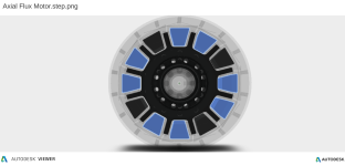

I'm interested in building my own axial flux motor.
TBH, I'm not sure if Emrax will come for me :lol: because it looks a lot like theirs. Whoever is interested in this tech, here is a Github link to the CAD files that I did in FreeCad while practicing to use it the program.
I'm a newbie to all of this so if you're interested in helping me make some enhancements to my design, feel free to reach out. Have an amazing day!
