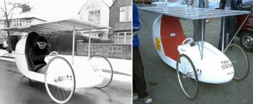

The very first e-bike I built, back in the late 1990s, had two arrays of spacecraft type GaAs cells. One on the disc front wheel and one mounted on the frame, they could deliver a combined 100W in full Texas sun. I don't know how much the guy paid for them, but I'm certain beyond any doubt that it was not $50,000 or even remotely close to that. Now I wonder what he was using, and what deal he stuck to get them.
Having worked on that project gave me a warped idea of PV performance for a long time.
A solar ebike in the 1990s? Impressive. I imagine the guy had to have some aerospace industry contacts to score GaAs cells. Even then, they were not likely flight-grade cells. Back then, commercially available residential PV panels were around $10/watt and around 10% efficiency.
I have an email from Spectrolab from 2007 when I was just getting started. I contacted them hoping that they would find my little project charming and might offer to sell me something from their scrap bin. Instead, they offered me flight-grade 28.3% efficiency cells at $300 each for a 26.6cm^2 cell with a $5000 minimum order. If I'm doing the math right, that works out to $400/watt if you're using the cells at sea level where you're getting 1000 watts/m^2. It's a better deal if you can ride your solar ebike at the top of the atmosphere* where the available solar resource is 1360 watts/m^2. :)
With SunPower selling 24% efficiency bare cells at around $2/watt, it's difficult to make the case for spending the money on satellite grade cells today. Even if you have the budget, you may achieve better results by spending it on weight savings elsewhere, like lightweight lamination and carbon fiber components. Even among solar race car teams with six figure budgets, multi-junction cells are uncommon. Part of that has to do with the race rules being written and re-written to incentivize innovation and engineering excellence over just "biggest budget wins."
* Low earth orbit, not high mountain passes.

It's come to my attention that I've missed a significant entry in the historical record. In 1984, Ugur Ortabasi designed a four-seat solar powered tandem and his team went on to win the World Championships of Solar Vehicles in 1986. Here's the trailer for a documentary film, currently in post-production.
[youtube]FtCJEEM_tw8[/youtube]
