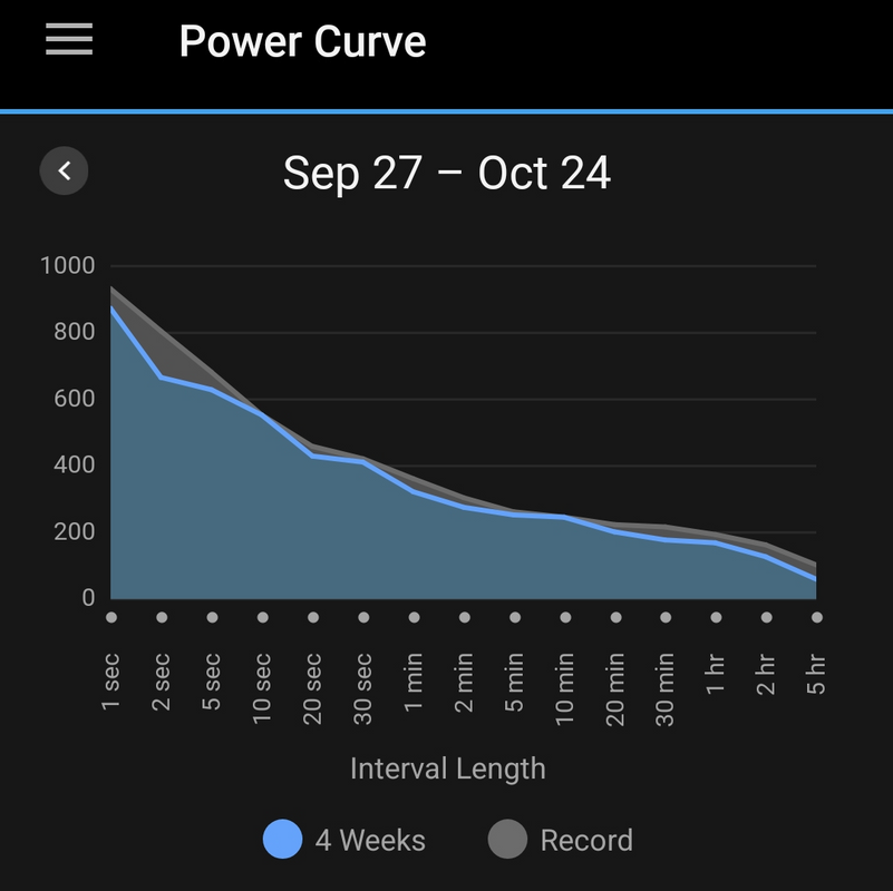

casainho said:
I am now more fit,.......
I do not like my M500 because the lowest assist level 1 is still to much for me, I wish it was way lower! But it is not only that, I wish to be force to always give my average 200W pedal power and only after that, the motor assist would turn on. See this graph:
This is a dream, as the original firmware does net let us configure such advanced modes. If we could develop our own firmware, we could do it. The pedal power value could be measured by the Bafang M500 torque sensor.
My power curve recorded by my pedals:
I understand fully your desired mode. the linear support is not the best. Actually your idea graph this look like a progressive mode? If you extrapolate the lines into something more smooth then it reminds me those graphs:
magic-jpg.63721

Just had quite interesting discussion with my former swimming coach. Now he is training runners from endurance point of view.
So... :
For every average human (including me of course ;)) it is normal that our power output is decreasing over hours of higher effort. At the same time as we get tired our heart rate is slightly increasing :!:
It needs regular dedicated training to be able to keep power output and hear-rate constant for longer time.
So my view is ideal would be to track two trends: the human power output trend over time and heart-rate trend over time. When the heart-rate is increasing but power is decreasing then the assist level shall be corrected with some value like +20 to 40%.
Is it possible with Bafang M500/600 torque sensor characteristics saturating at 40kg ?
BTW hope have seen those graphs about max torque and power generated by athlete cyclist:
The torque is going down with cadence increasing.
The power output has its peak at individual point depending on fitness level.
PS my individual hack for longer rides is to get proper heart warm-up by using low assistant level (seems contradictory but it works) also i try to not race by first 30-40minutes.

With my Bafang M500 motor, I just wish to have fine control of the motor power. I can look at my GPS cycling display and check my pedal power and heart rate. I would avoid to try implement any automatic control of the motor based on this.
And yes, I just feel the same as you describe and here is my pedal power curve from last year:
And with a zoom to show that I can withstand 200W on the first hour, 150W for next hour and then about 100W for next 3 hours (total of 5 hours ride):

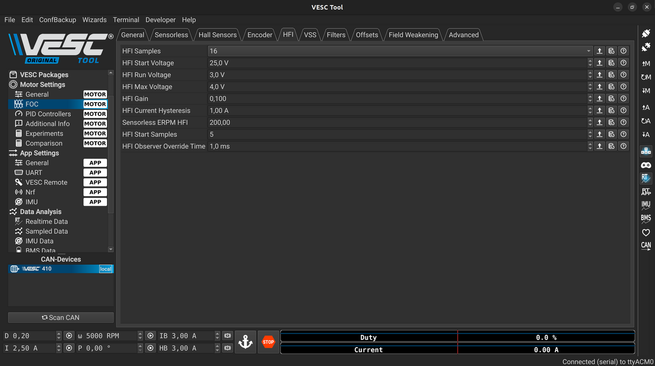

Since the Bafang is keep launching new motor models and not updating the firmware of previous recent models, like M500 and M600, I really think the best route is to go with VESC and forget about developing firmware for their original motor controllers!! For now I will try to go DIY, using VESC outside of my M500, but later maybe someone want to design, build, test and sell custom motor controllers based on VESC and for this Bafang motors.
Example of VESC EBike motor controller: Flipsky VESC 75100 EBike controller: 100€, 75V 100A, CAN and UART communication.
Advantages:
- BEST motor controller out there, OpenSource, small and powerful
- only 1 minute to make the inital motor auto detection setup, resulting in the best motor performance and silence out there!!
- VESC EBike application can be developed in high level scripting language
- powerful mobile app (also for PC and RaspberryPI), with high level scripting language for custom application
- display available to buy on shops, OpenSource (although for ESkates but easy to adapt for EBikes)
- there are A LOT of experienced users / developers of VESC
- powerful advanced algorithm for sensorless at motor 0 speed meaning no hall sensors needed
- cheaper than a Bafang original motor controller
Disadvantages:
- DIY solution
Video:
[youtube]H-6qzmeCNtw[/youtube]

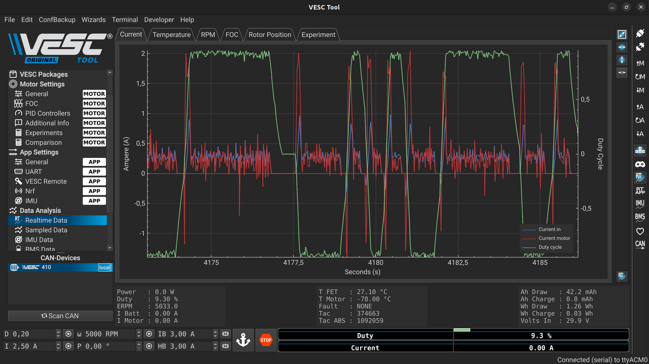

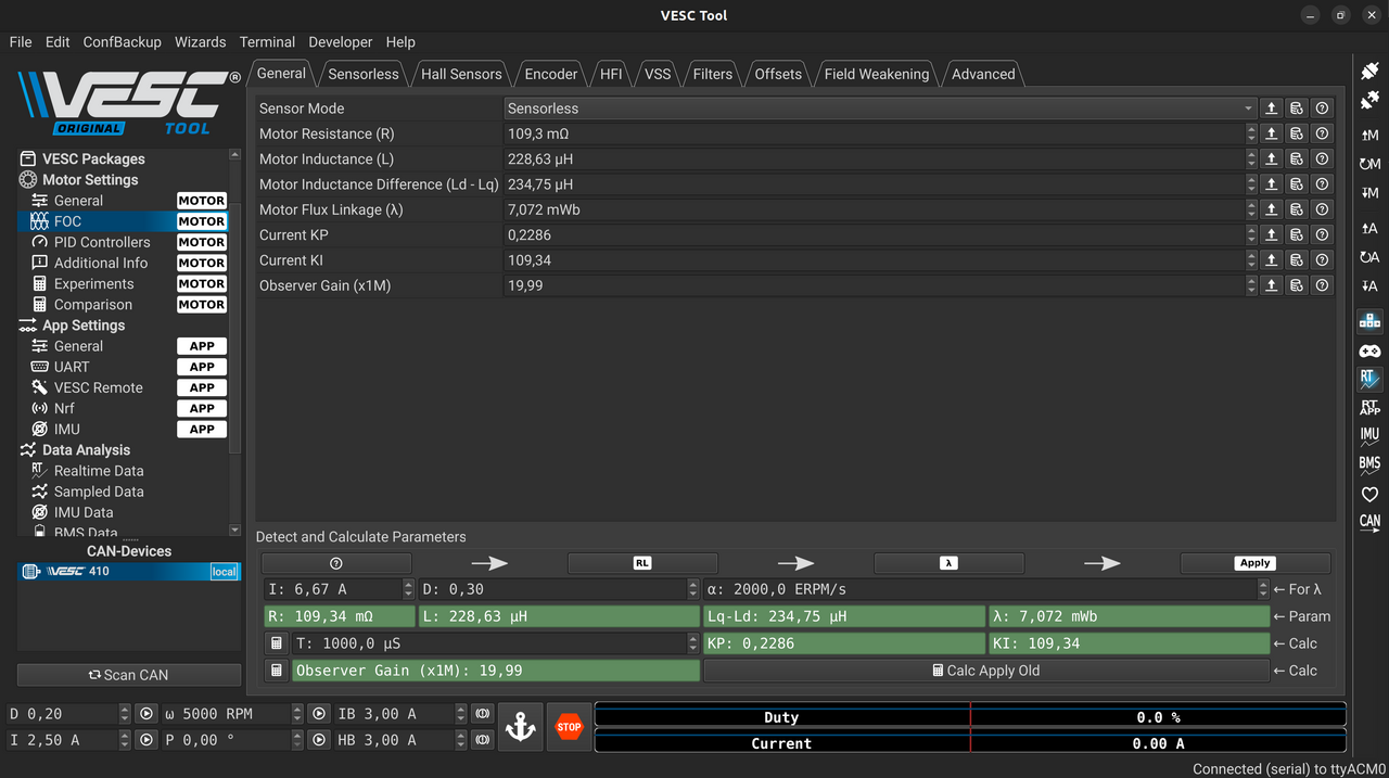

I connected an old VESC controller to the 48V TSDZ2 motor (I do not have yet a Bafang motor for development). VESC software were able to detect the motor characteristics:
I was tweaking the sensorless HFI silent mode and it seems to work well. I tried to block with pliers the motor shaft and I could feel the torque, although I did not tested it on the real EBike. I also did not connect the hall sensors as I am only interested on the sensorless mode, as I plan to run the Bafang motor in sensorless mode.
On this short video, you can see the motor running. Note that the motor is very silent but because it was attached on the metal vice, the noise was kind of amplified:
[youtube]-gTcE93ApKA[/youtube]
