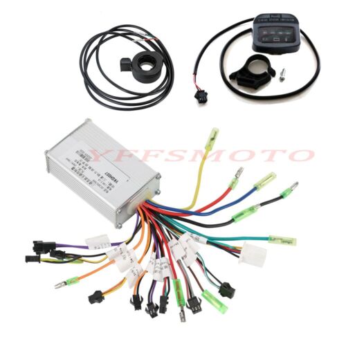

Unfortunately the half throttle didn’t do the trick with the Chinese controller I picked up. I was looking into reprogramming but I’m not sure this one can. I’m not opposed to picking up two new controllers or just ditching reverse all together if the price is too high.
When I plug in the batteries nothing happens, even if I twist throttle in the forward direction. As soon as I try the reverse direction, it recognizes the volts are lower and tries to use it as a full throttle. I return the half throttle to its neutral state and the hub keep spinning slowly since that’s 2.4V. I’m not sure if there’s a trick to getting this controller to learn but I did play with the self learning cable a bit without any luck.
I’m not afraid of soldering and I have plenty of DB9 cables from the lock programming I used to do but I’m assuming I’m SOL for reverse on this controller lol
If the controller is not designed to use a single throttle to control motor direction and/or braking, it cannot "learn" how to do this, you would have to create an external device to read the throttle's voltage and then apply signals to the controller that operate teh way the controller is actually designed to accept to do this job.
For instance, an Arduino nano with at least one analog input for the throttle, and at least one analog output to send throttle voltage to controller, and at least one digital to toggle the reverse line of the controller.
Assuming the controller has an input that is grounded to activate reverse, then the Nano will read throttle's output voltage and at the center-off position will output no voltage to the controller's throttle input, and leave the reverse input at 5v. As throttle voltage increases above the center-off voltage, then the nano will increase the voltage to the controller's throttle input proportionally. As throttle voltage decreases below the center-off voltage, then the nano will change the reverse input to 0V, and then increase the voltage to the controller's throttle input inversely proportional to the throttle input voltage.
It could also be done with op-amps and transistors if programming isn't your thing but electronics is.
You could use a controller like VESC-based types that have programmable throttle response and function, as long as it specifies that it *already* supports operating the direction *and* speed/torque of the motor from a single throttle input without using any other inputs.
The "learn" function of a controller is only there to let it determine the phase / hall wiring combination automatically, rather than having to manually swap wires around to get the motor running correctly.
