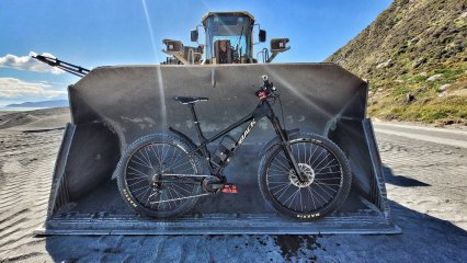

Just a few km shy of 3000km, 3 years soon too, no motor issues to date, only external stuff like ISIS splines and BB cup bearing failure. In user's experience, should I be considering opening the unit to service/repack it? It is a little noisier than I recall it being but nothing particularly concerning. I worry that I might do more harm than good.
Oh yeah, needed a lift...
