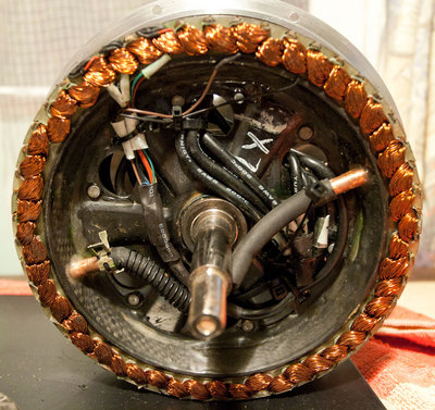

So in the end, we lined the cooler with a plastic bag to deal with leakage, and then glued a thermistor to each of the motor cores and side plates. Rather than relying on boiling water to heat the cores up, we could then use a convection oven, and not have to worry about evaporative cooling during the transfer from the oven to the bath.

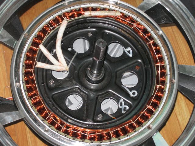

Our goal here was to measure the specific heat capacities of a number of existing motor cores and motor shells, in order to see how much spread there was between different hubs and come up with a good average value that we can use to derive effective heat capacity by just weighing the motor. The motor components are made from iron, aluminum, and copper, and these have theoretical specific heats as follows:
Iron: 0.44 J/gK
Aluminum: 0.89 J/gK
Copper: 0.39 J/gK
So the actual specific heat capacity would depend on the ratio of these metals in the motor parts, which shouldn't vary too much from motor to motor.
All told we had 7 direct drive motors of various vintages for testing
