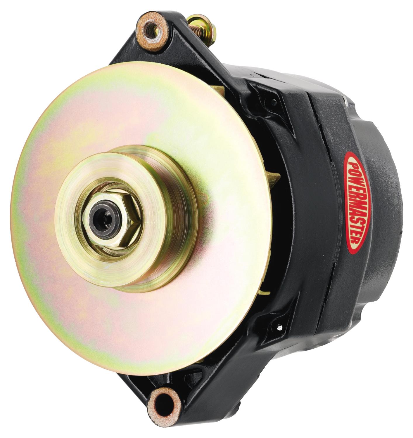

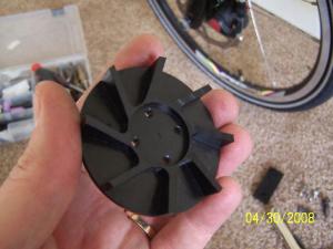

Based on hjns's message, the vanes are attached to the side covers, they're not driven by a separate motor but spin with the hub
Lebowski, I am a firm believer that this is the best style of fan for hubs, mounted on the disc-brake side, with the fan-holes near the center of the hub. for the other side, I would guess having the holes near the rim?

This is the style of fan that bluefang is using

Delco-Remy alternator, CS-144A truck alternator, 1986-present (27 years so far)
GM 12SI style 140A

The paddles on the spinning fan create a low pressure area behind them. A low pressure area further evacuated by the face of the next paddle passing through. Air in the area encaged by the paddles is drawn to the low pressure swept area and is then expelled by the face of the next paddle. This puts the area caged in by the spinning paddles under considerable vacuum, when compaired to the atmospheric pressure within the motor enclosure.
It is this low pressure area within the fan cage that draws air in from the motor casing. The air in the motor then drops below atmospheric, so cold air from outside will be drawn in through the back bracket. In turn it will pass through the motor, getting stirred about along the way. Before heading through the front bracket to be drawn to the blades that bat it out in to the atmosphere again.
I'm not 100% sure about the batting. It could be inertia and centrifugal forces that carry air through the vacuum and out the other side. It's perhaps unimportant.
Perhaps I'm just not seeing the first drawing properly. It appears to use some fan power to circulate air back and forth through the front bracket. This would still cause some cold air to enter through the back bracket, but much of the fans vacuum ability is lost to recirculating hot air through the front bracket.
The fan I pictured is an alternator fan. They have space issues too. It might offer a few mounting options. Even drilling 100mm out of the middle and putting it round the yoke like a skirt. Once you have that image in your mind, you can't help thinking that.........
