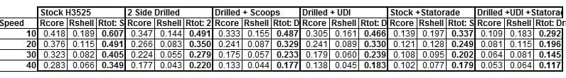

Well while cleaning up around my bench the other week I stumbled on a 3D printed 'under disk impeller' device that Pendagron8000 had shipped here earlier this year but I thought I had misplaced, it's one of these devices that is form fit for the disk mounting boss of a Crysalyte 'H' series side cover, as detailed here:
https://endless-sphere.com/forums/viewtopic.php?f=2&t=48753&p=1031080#p1030705
So I decided to use this opportunity and do a similar set of comprehensive comparison tests as what I'd done with the MXUS motor, only using the Crysatlyte H3525 hub.
I drilled out six 3/4" holes on the disk side towards the center, and nine 3/4" holes on the freewheel side towards the perimeter. This is a much smaller total drilled out area compared to what I did with the MXUS motor and is more representative of the kinds of mods people have been typically doing.
As a matter of curiosity, I also tried making radial facing scoops to more explicitly capture forwards moving air into the disk cover holes in order to see if that had any better or worse characteristics to the 'impeller' system. This was done by cutting sections of a 90 degree bent elbow of PVC conduit pipe and gluing them to the side plate like so:
And the whole thing was put in the wind tunnel, run with ~ 100 watts of heat generation until steady state reached at 4 different speeds and RPMs, and run first with the vent holes taped up, then with the vent holes open but no external air flow enhancers, then with the under disk impeller added, and finally the radial scoops on there instead.
And what do we see? Stock motor has a resistance of 0.61 deg/watt at 10kph dropping down to 0.35 deg/watt at 40kph. With the 3/4" holes opened up on both side covers, this drops by about 0.13 deg/watt across the speed range. Both the radial scoops and the U.D.I have almost identical effects, showing very little improvement at all over just the plain holes at the lower 10-20 kph speeds, but becoming noticeably better at higher speeds. At 40 kph, the bare holes have a resistance of 0.22 deg/watt, adding the U.D.I. improves this by 20% to 0.183 deg/watt. At 40 kph the scoops meanwhile improve on bare holes by 24%, to 0.177 deg/watt
Now for fun how does the addition of Ferrofluid affect the results? I then repeated the tests with 6mL of Statorade added to the hub, in one case with the holes taped up again and in another with the holes open and the U.D.I. attached. In this experiment, the performance of Statorade with no vent holes at all was substantially better than the vented motor at lower speeds, even with the flow enhancers, and it's only the final test at 40 kph where the vented motor with scoops or impellers catch up, and look like this beyond 40kph speeds they will cross over to be more effective:
And as with the case with the MXUS experiments, when we combined the Statorade PLUS the vented motor with flow enhancement, the overall effects combine and we get excellent low speed and high speed thermal conductivity. At 40 kph, we're down to 0.117 deg/watt, versus 0.349 deg/watt on the stock motor, so a factor of 3 total improvement in heat flow.
The results in tabulated form are here
thanks for the further tests.
when using statorade and drilling additionally holes to the covers, it will improve things by another 50-100% (hopefully i'm right this time with the numbers :lol: ), but how would it look after some miles in real world with dust and small debris inside the motor gum up with the FF?
IMO this is something you do not want to have so either statorade or drilling, but not both.
look what i have done with a MXUS 45H rotor:
i turned off almost 1kg of material and increased the surface area. the back iron now is about 2,5-3mm thick at the bottom of the fins. the fins are about 3mm deep. since a paper clip does not show magnetism on the outer surface, the thickness should be sufficient.
with custom made sidecovers with integrated spoke flange (similar to the prototype of Justins Grin Tech motor, or Bionx), i believe the MXUS 3000 could be turned into a 7kg motor making hub drive MUCH more attractive 8)

I'm with you on the either/or thing for holes and FF. It may be easier than I thought to clean out, but I only want to open motors once or never, at least until years later when the bearings wear out.
FWIW, the ultimate proof that you haven't changed any necessary portion of the back iron is verifying that the Kv hasn't changed.

That's correct in that it will increase the ability of the motor core to shed its heat to the outside air by 50-100%. Just don't phrase it in a way that says the motor performance will increase by 50-100%, that would be quite misleading! Motor performance for the most part will feel just the same, but the temperature of the stator will be quite a bit cooler in use, and as a result you can put more continuous heat into the core without causing it to overheat.
That's a great question that only by testing it out will we know. Here in Vancouver the air is clean and there is practically no dust and debris to get in, just rain, but if someone goes out trail riding in the dirt then that would be a better way to know. People have been using the phrase "gummed up" quite often on this thread but I think that's a bit of a loaded statement, we're talking just a few mL of liquid, and if it were to get contaminated with a bunch of foreign particulates I doubt there would be any effect on the motor. It would just get pushed aside and would loose its effectiveness at cooling. I'll have an update on rain + statorade at the end of the holidays but I can't do any dust testing really till summer.
