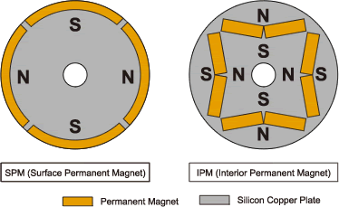

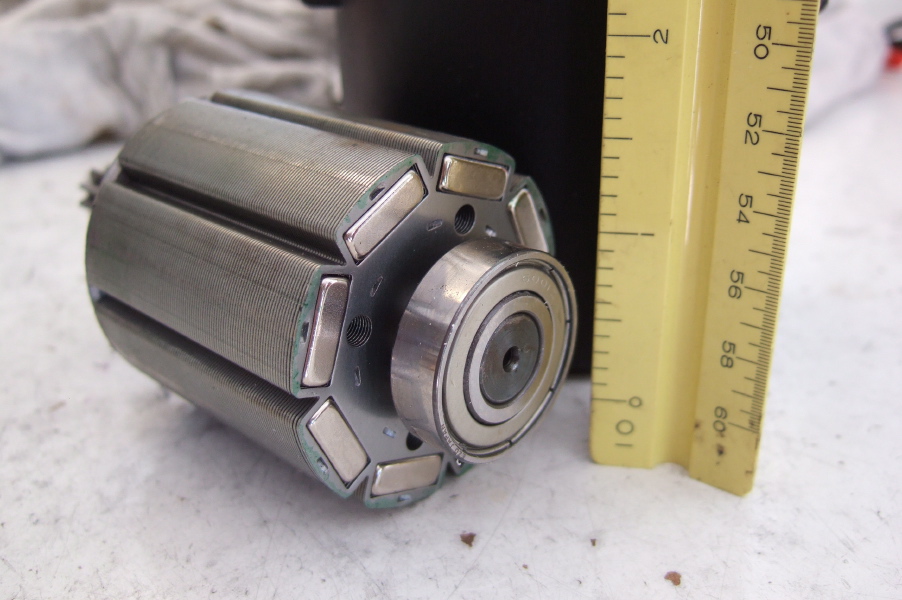

spinningmagnets said:
IPM = "X" Permanent Magnet ?
Whats the "I"?
Thats IPM for sure! I don't know how that BEMF is going to look like anything but a snarl, but it's IPM.
Its the Headline rotor. Found in Cyclone 500W/650W/750W, etc...also AFT and EGO. The only complaint I've heard is that the very robust steel reduction gears are very noisy, and yet they have never upgraded to a slight helical tooth...
What are the advantages / drawbacks of IPM vs SPM, since this is very pertinent to the "motor design for local production" thread.
With the laminations being laser-cut, and the shafts being made on a local CNC, a small extra cost to avoid interruptions in the non-hub motor supply is well worth it (IMHO).
ie...we should continue to leverage affordable motors from China as long as they are available, but...when the proverbial "manure hits the air circulation device", I would appreciate having an idea of what a locally-made design would look like, using best available practices and designs.
I will let Biff answer that. At 15min mark IPM part begins.

You got the new Zero motor? From what I can gather from memory from a youtube posted here showing the Zero's new motors those where IPM's?

Also, water works well for cooling because of the phase change between liquid water to vapor water consuming a bunch of energy. While things like dry ice or liquid N2 have very low boiling/sublimation points, they don't actually absorb diddly squat for thermal energy compared to water. Likewise a compressed air blast would give you a couple seconds of slight cooling but any size air tank you could carry would not be as useful as even a tiny couple fluid oz bottle of water.
eTrike said:
Increased cost, more efficiency? I saw a 30% figure floating around, so a 90% efficient motor could be 93% efficient?
For the Zero SPM to IPM it was ~95.3% measured peak as an SPM and ~96.6% measured peak as IPM if I recall correctly. Ryan would obviously know better.
With respect to range, that is almost unnoticeable, with respect to this threads topic on cooling, it means ~38% less heating (while at peak efficiency).
