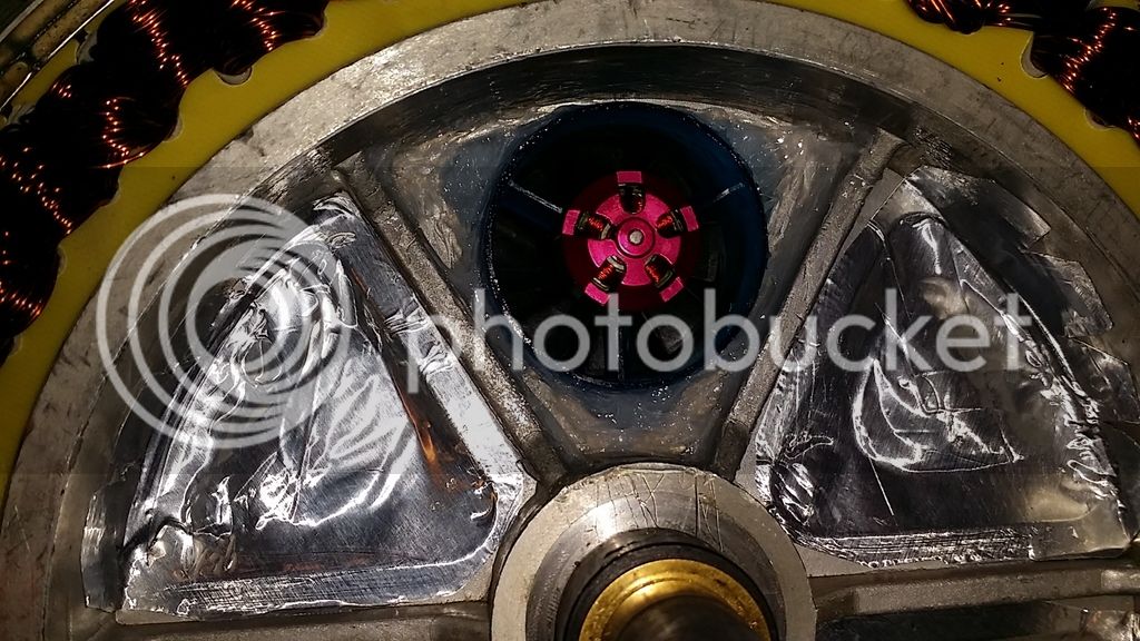

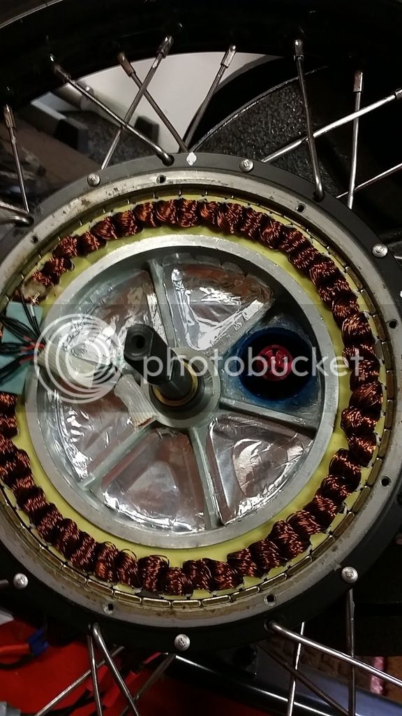

Working on installing my EDF today. I'm using a 35 mm EDF, with a 6000 KV motor. Comparing this to my old 30mm EDF with a 13,000 KV, I can run this at 12 volts instead of 8 and use much less amps. This 35mm EDF will easily blow double the air as the old 30mm 13,000 KV one, and the old one blew a lot of air.
Here are some pictures for those who are interested in how I set this up.
I use this sticky aluminum tape I think is used for duct AC or heating. I put it on both sides and it simply works well, is light weight, easy to install, and may offer some thermal advantages compared to plastic.
You can see the enlarged hole for the 35 mm EDF

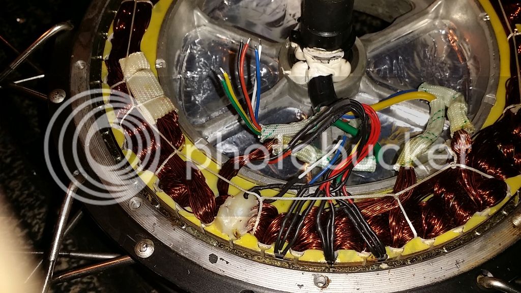

The MXUS Turbo has two sets of halls and temp gauges. Since I only need one side they will give me a free 6 wires to easily connect the 3 phase EDF, I will use 2 wires per gauge. In my old setup I ran a single 24 AWG wire to each phase and that was not enough as the wires got hot.
I certainly don't want to run new wires and have to deal with getting them through the hub and replacing the stock setup.
If you look closely you will see that MXUS temp gauge wire actually broke off the temp probe by just lightly pushing on it, MXUS is known for their bad quality control.
Here I use silicone to glue the EDF in place because it holds it sturdy enough and I can easily remove the EDF and remove the silicone if needed.
