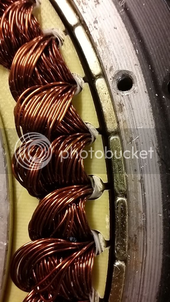

Just wanted to update on my findings of using forced air EDF (electronic ducted fan) in a sealed hub motor. To give you an idea about how power a 35mm EDF is, if you hold it arm length away from your face and put it on full power it is like you stuck your head out of a car riding at highway speed, it is even hard to breathe. You can't compare this to a CPU fan, or even a large room fan in the power it has.
First I wanted to say my original thoughts were correct in that there must be a thermal bottleneck in the transfer of heat out of the hubmotor. Most likely through the metal case. I question the usefulness of hubsinks if you are moving at even moderate levels of speed.
With having my EDF installed I took my bike out today in a very cold 45F / 7C day, pushing about 6500-7000 watts on my MXUS turbo.
It takes a long time to heat the motor up even with the EDF OFF, the only way to heat my motor up without riding offroad (it was too wet and muddy to do that), what I need to do is full throttle the bike, then hit regen braking, full throttle it again, if I continuously do that it will heat the motor up fast.
After riding around long enough and finally being able to keep the windings at around 115C / 240F, with my cooling OFF, the outside case temp will only be slightly warm to the touch, and only reach 100F / 38C even after sitting for a long time. My MXUS motor has very bad thermal transfer.
When I turn my EDF ON after the motor is fully heated, the side cover on the exhaust side would get hot first and somewhat fast, maybe 1-3 minutes, so not super fast. This is because it is getting hit with super fast air speed.
My exhaust side cover would reach a max of 140 F / 60 C, it would take about a minute or so more time for the magnet ring and other side cover, to get to the same temp as the exhaust side cover. But eventually the whole hub will be 140 F / 60C, at 140F this is burning hot to the touch. This is with the bike stopped and indoors. After the bike sitting for 3-5 minutes to get the hub super hot at 60C, my winding temp stays at around 170F / 76C, and slowly fall to 150F / 65C, it takes a very long time to fall below 170F.
Here is where it gets interesting:
With my hub now at 140F / 60C, which is burning hot to the touch, and my EDF ON at almost medium speed, as long as I drive at 15-20MPH the whole hub will now only be slightly warm to the touch. As long as I am moving it seems that the hub motor will quickly cool itself and just be warm at around 90F / 32C . This is even after I turned my EDF at full speed using 100 watts of power, and also full throttle, stop, full throttle, reapeat.., up a hill to get my windings to stay at 115C / 240F .
Even when my side covers are at 140F / 60C, which is as hot as I can get them stopped, they will cool off in like 10 seconds while riding. This is even the exhaust side cover which gets Hot First and fast and hit directly with the high speed directly from the EDF.
This means that since my hub motor is basically just warm to the touch while riding, it tells me that hub sinks may be useless unless of course I want cooling when I am stopped.

What also is interesting is that you would think the bottle neck would arise in the windings to stator transfer. However, this does not seem to be the case because the stator seems to suck all the heat up until the stator gets too saturated with heat. This is because you can full throttle the ebike for a very long time on a cold motor before the windings get hot.
Justin also potted the windings to the stator, trying to fill in all the air gaps around the windings, and this offered almost no benefit with the FF/satoraide.
I would assume this is because the windings are wrapped tightly around the stator at enough points to transfer the heat to the stator fast enough, even though the windings are separated by plastic and fiberglass which are also bad conductors. I would still bet there is a thermal bottleneck here also, but not nearly as bad as the stator to magnet gap.
