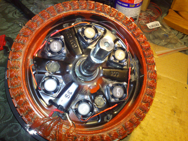

As one of the only other guy's out there still running fans in my hub, I guess I should provide an update on mine also. For those unaware, I'm using 12 x 25mm (6 on each side) RC esc cooling fans mounted in the existing hub support holes running in series directly off my main battery:
Well I haven't opened my motor in at least 1500km now and it's still going strong. I regularly push 6KW peaks, 3-4KW cont. through it and it only ever gets over 135C on very long climbs or on slow steep technical stuff where something like a MXUS 3K with FF is struggling just as much.

Awesome job fitting serious fan power inside that motor buddy!

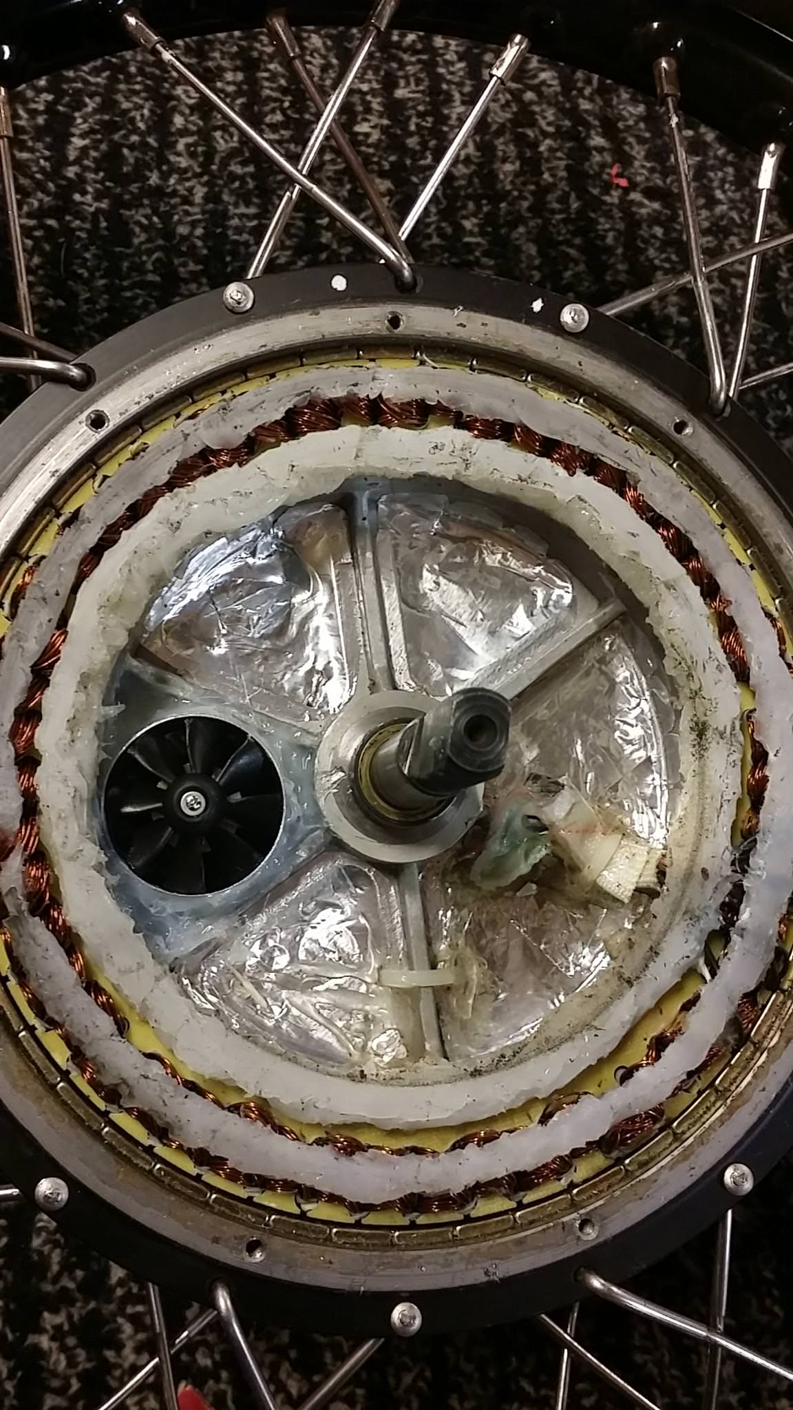

I just wanted to give an update about my 40mm EDF fan in my MXUS 3000 Turbo hub motor. The motor is ducted using silicone to direct outside air through the coils. The side cover of my hub motor has holes drilled into it.
I can say that I've ran it the whole last summer, and am running it this summer without any issues. When the weather is hot outside and around 90F degrees, this is the time I like most to ride my bike and also the most difficult times to deal with motor cooling, I am pushing the MXUS motor hard at 8000KW for a very long time with my large 3 KWH battery. I ride extremely hard with only using full throttle.
The silicone ducting I made directly on the coils and aluminum stator has held up without any issues.
I can adjust the speed of the EDF fan and with the very hot summer days I need to turn it up to 80 watts (this is what the 12 volt power supply draws as read on my Max-E) to be able to drive my bike as hard as I can with any risk of overheating. The great thing is I run this 40mm EDF at these high speeds for my entire 1-2 hour bike rides without any issues. This tiny EDF is very reliable and very powerful also at moving air. When this tiny EDF is using 80 watts it is spinning extremely fast, if you held the fan at arms length away it would feel like sticking your head out of a car window driving on the highway. No computer fan would even come close, these fans are used to fly airplanes at very high speeds.
The noise isn't too bad but it isn't silent. At a speed above 15MPH you won't hear it over the wind noise. You do get used to the noise, just like you would the noise of your car, you just don't notice it. The great thing is I can adjust it by reaching back under my seat, so if I want it silent I just turn the knob and I can do this while riding also.

liveforphysics: Thanks. The surprising thing is that this small 40mm fan is spinning so fast, probably around 50K RPMs, and yet it is so reliable. I run it sometimes 2 hours for a ride and they last for years. I was worried that they were not built to be run for such long duration because most people use them for short RC flights.

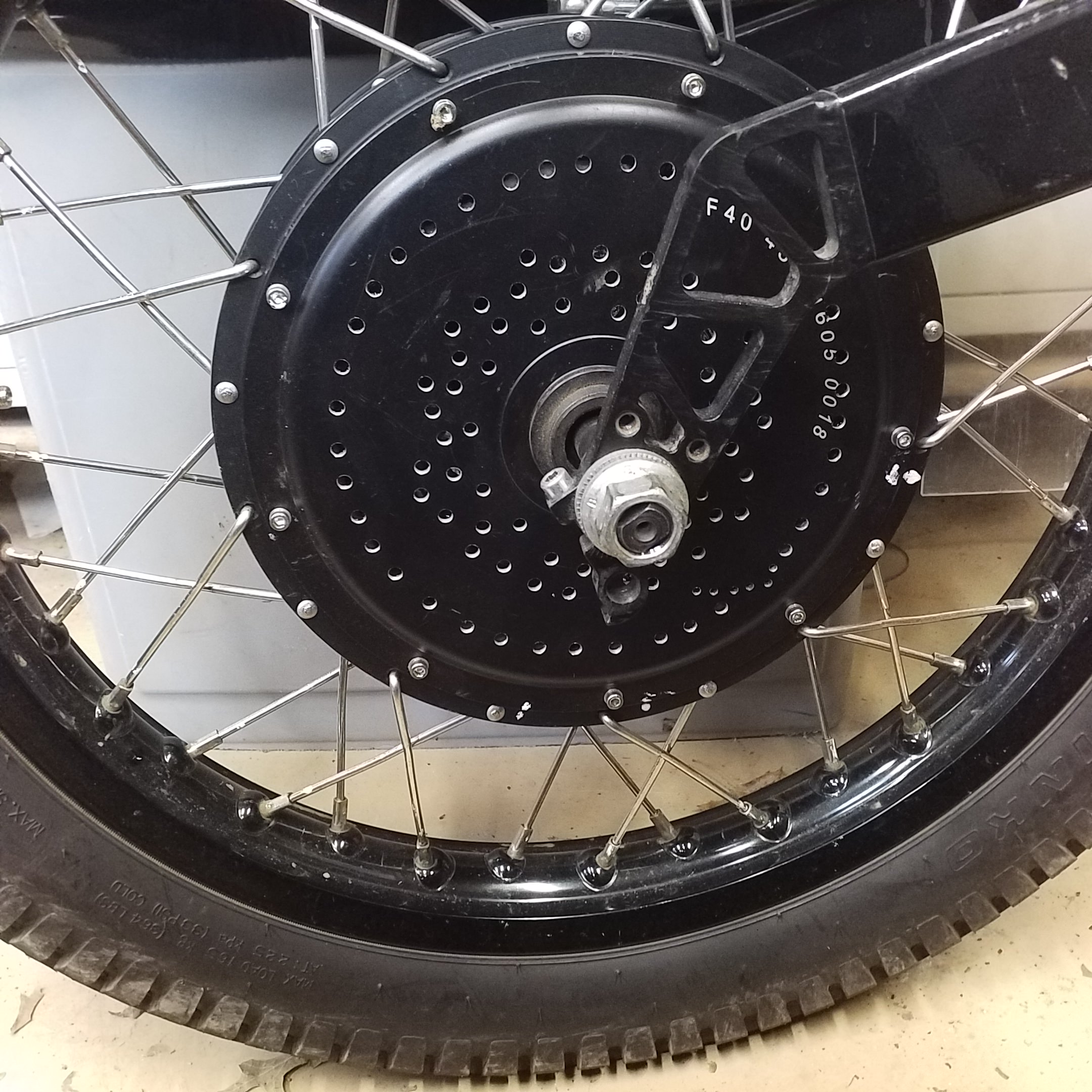

I'm experimenting with adding ferrofluid to a vented/varnished hub. My goal is to add a mesh/screen over the holes, I mostly ride offroad so my concern is dirt getting into the motor and gumming up the ferrofluid.
1st pic below is my swiss cheese hub motor and 2nd pic is the proposed screen cover idea, using stocking material and duct tape just as a mock-up. For the final version I want to use some kind of metal mesh for durability and glue it to the hub. I'm having trouble finding anything with super fine holes though. I'd like to keep as much dirt etc. out of the motor as possible, so mesh with holes as small as possible is necessary.
Does anyone have experience with a vented hub and ferrofluid, how has the ferrofluid held up over time?

I think I am gonna skip the screen/mesh altogether after thinking about it, it's really hard for rocks/debris to even get into the motor anyway and it's almost impossible to keep out dust or small particles that can gum up the ferrofluid since my motor is already vented. Thanks for the info.
Yeah, I looked into a mesh/grate type solution for my fan cooling and decided against it because of the complexity and reduced air flow.
As for adding FF together with venting I think it should work fine. The gumming up I saw was only on the one motor and with forced fan cooling and large vent holes. It also did not impact performance in anyway and I only noticed it when opening it up for other reasons. I would say it's worth giving it a try and seeing how it goes. I highly doubt it would cause any problems in the medium term and the fact that my other motor with forced fan cooling + FF setup is still going strong after thousands of kms would attest to it lasting long term.
