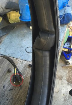

So had the Bomber out now for several rides with the TC4080 conversion. One of things I had to do was change the pole count from 12 to 62. With the correct wheel set at 1925mm, I was hitting my CA V2.25 99MPH limit and shutting power at around 7MPH. So, with the help of my Garvin GPS, I set out to find the correct settings for speed readings. First I went to 23 wich is the correct pole count for this motor as it has 46 magnets. It helped a little, but I was still hitting 99MPH and shutting down, but I was going somewhere around 18MPH when that happened. So I started experimenting with increasing pole count settings. Well, with the pole count set at 62, everything is perfect. CA speed display is 42MPH and GPS is 42MPH. Also distance traveled measured accurately within 10 meters, and that difference could be the time it took the GPS display to update. I don't see any problems with running the pole count this high. I had posted earlier that the WOT speed of the TC4080 was 2600watts, about 900watts less than the 5404 under same conditions, but that was with only adjusting the CA wheel size setting to 500mm. Now with the wheel setting correct and pole count increased, I am seeing right about 3000watts now. This makes more sense as this amount of watts consumed is about the same, just slighlty higher, than my Fighter @ 41MPH after terminal velocity is achieved. So my question is: why does my CA V2.25 need the Pole Count set at 62 and not 23 to work properly with the TC4080?
///Edit 500mm not 5000mm for wheel size ///
Found the culprit, when I first got the TC4080, the phase and sensor wires were way to short. So I chopped the phase wires off down near the axle and stepped in 10g wires like I did on the 5404. Then I had to splice and extend the sensor wires. There are 5 tiny 24g wires that I had to individually splice and resolder extensions too. Well, because they are so small, and I was using a 140watt solder iron, I couldn't put much heat time into each wire. Long story short, reinspected the wires and discovered one of the splices, redish/orange wire had a cold solder contact. it was floating and touching each other but for all intensive purposes was two separate wires. So I heated up the splice. Everything works perfectly now, 23 pole count for settings and display is accurate.
