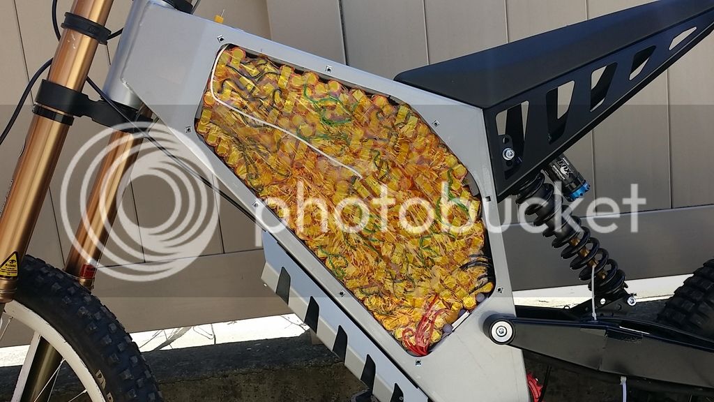

Here is my completed operational but I still need to run balance wires and parallel connections, but I'm using it without those right now. It is a 20s14P, using 280 3500MAH cells.
I know some of you thought my pack may seem unsafe, but I believe it is extremely safe. I wrapped the pack tight with kapton tape so there should never be a loose wire. The wires are held firmly to the pack.
The pack is also inside my frame so tight I need to actually push it in and out with my knees. Pack is then compressed from the sides with foam when I put the side covers on.
The closed cell foam compresses around the cell edges, in a way molds around the pack to hold it in very firmly.
Series connections I used 7 separate 16 gauge copper wire, which is equivalent to about an 8 gauge wire. Think about it, you would need to connect each series group with four 8 gauge wires of nickel to get the same resistance. Voltage losses are extremely low.
Pack is perfectly cell balanced between all cells in the very oddly shaped pack which is not rectangular or square. I even used the 16 AWG wire to connect to my controller in equal length. I also needed the wires to be flat when coming out of the pack because frame width is only 76 mm.
It was a real pain to build it this way. 140 separate wires, 280 nickel tabs to be tinned. 280 wire ends to be tinned. 280 nickel plates to be cut and welded. Wires needed to be soldered to all the nickel. Difficult to align all the wires to be as short as possible and to not overlap another wire because the pack needed to be perfectly flat. All the nickel with wires attached had to be spot welded, which moved around especially when connected on one side. Took me hours to build it this way. Each series group probably averaged about 3 to 4 hours to do. Very detailed work to get it done without overlapping wires and wires the same length.
I would have loved to just weld some nickel if I thought it was better that way.
Looks ok to me Offroader.
I like the fact that you can still see the cells through the kapton tape. Makes for easy visual identification if something goes wrong.
I also like how you've used every bit of available space in that frame. What kind of range are you expecting from the pack?
Cheers
Cheers
Yes seeing though it is helpful. I actually have probed through it and tested individual cells.
The pack is rated at 3.5 KW, but the Sanyo 3500's are more like 3300 MAH cells, so its more like a 3.3 KW pack.
I hope to get about 2800 watt hours from my max-e, which would be about 72 KM of hard miles. Or hard riding at around 7.5KW of power. My old pack of 24 packs of 6s 5000 MAH, I only got about 48 KM on average in the summer or around 1800-2000 watt hours from my max-e.
I didn't get to test a full battery yet, hopefully in the next few days I'll test a full charge and see how much I can get out of it.
